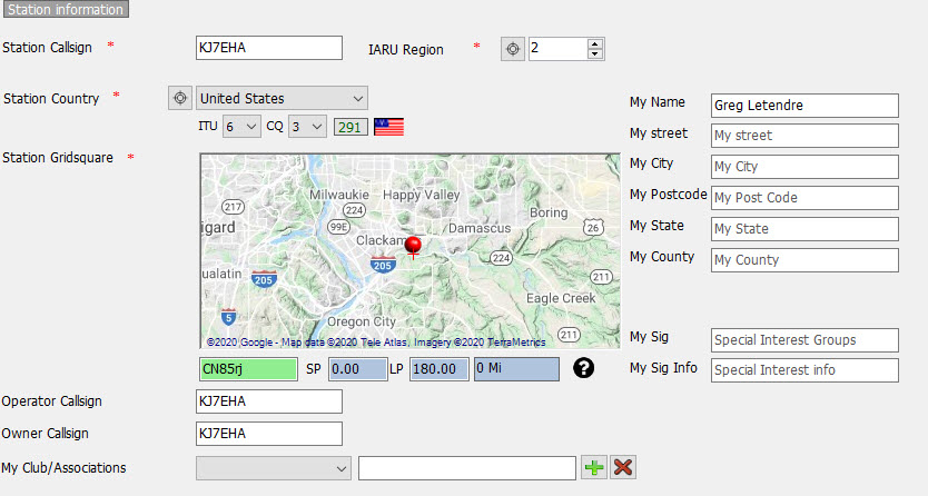

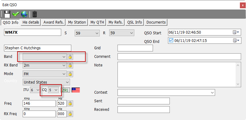

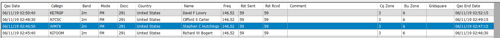

I am new to Log4OM, I did not have V1. I have a clean V2 install. No previous database.
I am in grid square CN85. I set my station configuration to ITU=6, CQ=3, DXCC=291
I think the program is miscalculating my CQ region as 5. I reset the QSOs I enter to 3, but then when I open the edit window they are reset to 5.
Also, when I open the edit QSO window, the program appears to clear the "Band" setting I made originally.
Attaching images of what I am seeing.

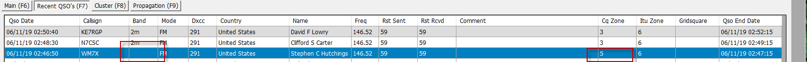

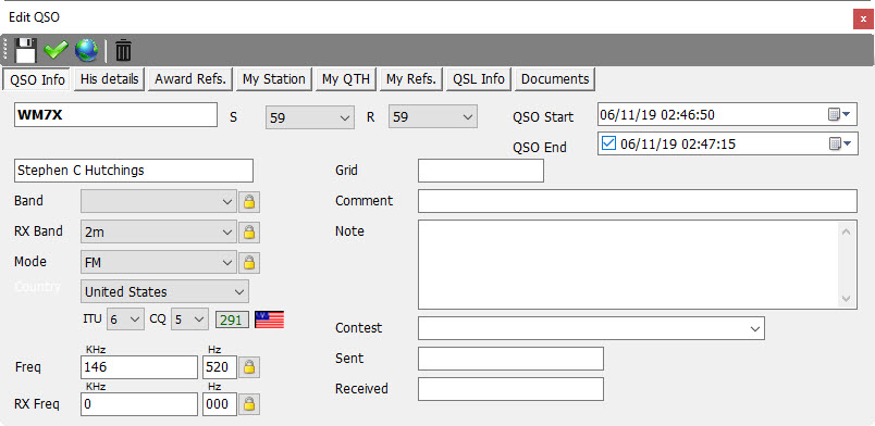

The QSO was in WA state. Am I correct that WA is in CQ zone 3?
I manually set the CQ zone to 3 when I created the QSO because it came up as 5 by default. I thought CQ zone 5 was on the Eastern US. After adding fields to the QSO I saved it.
When I double click on the QSO to edit it, the CQ zone is reset to 5 automatically, and the Band Field is cleared.
Then when I save the QSO the fields I did not change are changed upon save.

Change frequency from 146 to 146000 and 520 Hz so the frequency must be in kHz and Hz but 146 is in MHz.
If you do so the band will be show´n as 2m.
Easiest way is when your radio can be controlled by CAT via Omnirig. Log4OM will grab the correct frequency automaticly.
