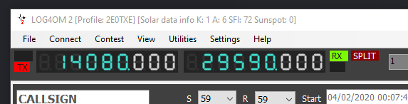

Radio is FT-950, Log4OM v2 insists the radio is in split mode. Radio is NOT in split mode. Activing split mode from the radio has no effect in Log4OM. Clicking on split will not get the software out of split operation.
Annotation 2020-02-04 000756.png (13.31 KiB) Viewed 8182 times
Has been this way on all v2 releases and still is not fixed.
Log4OM v1.4 works fine, no problems. As do other logging softwares. Just Log4OM v2 screws up says split operation is active.
Same outcome on Desktop PC, Laptop and Windows 10 tablet.

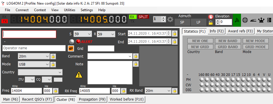

Hello!
I use Log4OM 2.9.0.0 and FT-891 connected by OmniRig.
All works OK, but when I working Split Mode, TX and RX VFO are switched. On the Radio, VFO A is for RX and VFO B is for TX. On the logger, VFO A is marked as TX and VFO B as RX. Not a big problem, but all Split Mode QSO's are logged with switched frequencies. And if I want to put someone in the cluster, I need to manually input his frequency.
Can it be resolved?
