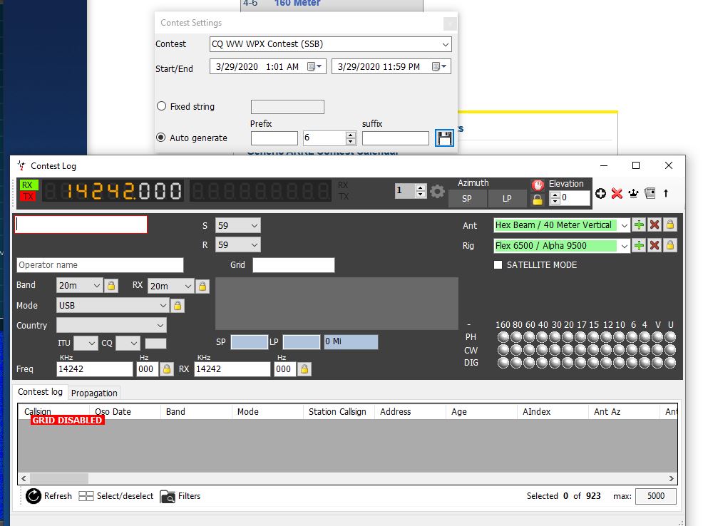

I want thank everyone involved for trying to help out in regards to the contest programs,
By the time I was able to figure out the procedure for printing pictures in Windows 10 it was pass the close of the contest so I was unable to show you the screen shots as they were during the contest. The setup is correct.
Now if I place a contact call in the contest and try to save it as a QSO it just tells me the conest is over.
Not sure how else to test this to show you what was happening.
Howard
AH6TX
CONTEST - NOT ACCEPTING CONTACTS
Re: CONTEST - NOT ACCEPTING CONTACTS
Hi All,
First of all I want to apologize for the delay in obtaining the Screen Pics as Windows 10 is quite different then in all previous versions. Of course by the time I learned to use the program it was after the contest was over thus only able to give you the correct contest setup and of course the contest log as of now.
In reading the last comments it appears that instead of putting in the contest in the Contest Received location this is where the contact provides me with the sequence number. If you have anything I can use to test this with I would appreciate it so I can be ready for the next contest.
Attached is the screen shots.
Thanks again
AH6TX
Howard
Thanks again
AH6TX
Howard
Howard,
To test, just go to contest settings and extend the contest end date to later today. Then try to enter a contest QSO.
Doug
W7DRM
Doug
W7DRM
Doug - NN7D
Gig Harbor, WA, USA
Gig Harbor, WA, USA
Hi Doug,
It worked!!! now I know what to do. I appreciate all of your help.
Howard
Howard

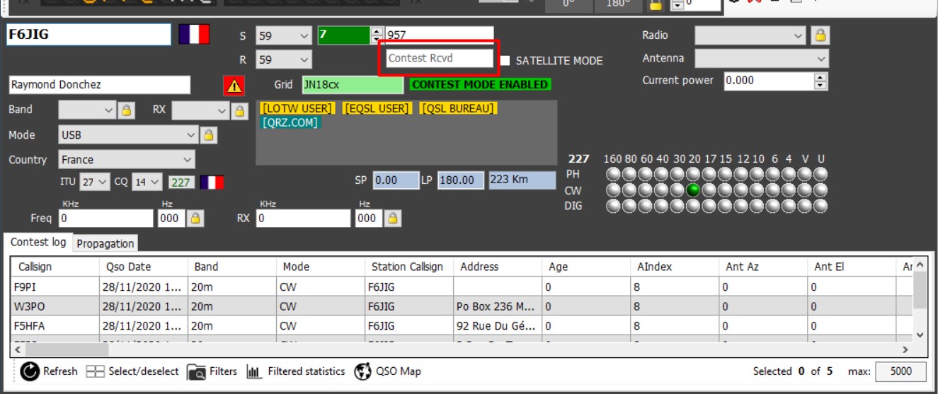

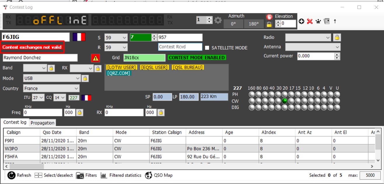

could you tell me which information you have to put in the field "Contest Rcvd"messager "
Il i put anything i can log the station but if the field is empty i have a message "Contest Exchanges is not valid"
Thanks for your answer
Raymond F6JIG
Raymond F6JIG
Raymond,
You need to enter the contest exchange information which you received from the other station, whatever is required by the contest rules. For the CQ WW CW contest, its RST report plus CQ Zone.
If you don't want to enter anything, then turn off contest mode.
Doug
NN7D
Doug
NN7D
