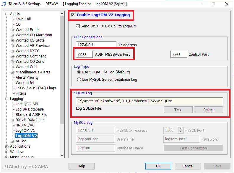

Hello OM (a name in a signature would be fine),
have you enabled Log4OM V2 logging checkbox in JTalert ?
Are the UDP ADIF_MESSAGE port the same in JTalert AND in Log4OM V2 ?
The path to your database correct ?
At my side all is working fine with logging via JTalert ...

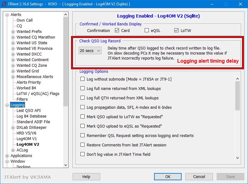

Re: JTalert fails to log QSO
And, as I recall, there is a alert duration timer that can be set inside JTAlert as to when that message will appear (or not).
- JTAlert_logging.JPG (137.39 KiB) Viewed 3838 times

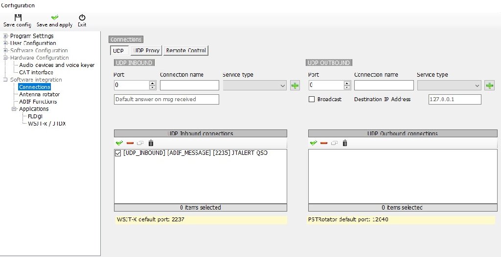

Hi guys, thanks for replies.
Yes i have set the options as per guides, i will take some screenshots shortly and post. And Terry, no the QSO is not logged at all (i logged then manually after session).
Doug,
PLEASE, when you post a support reply - include some actual advice or POINTERS, rather than just scolding a member and telling a user to read the manual!
Latest versions of everything i believe: Log4om: 2.6.1.0 // Manual 20/5/20
And believe me i did read it and had followed it, maybe not in the screenshots above true, but i have spend ages trying several different configurations, including following the manual to the letter (with jt_message and rebroadcast on 1240) , still didn't log the QSO at all. In fact i had issues with JTalert functioning at that point, the settings above have everything working EXCEPT automatic logging.
I think it doesn't help a user when here we have 3 pieces of software, each with its own manual, each manual differ in setup. Ie in JTalert manual it shows the setup i have above. Youtube videos show the setup above and working. Its confusing trying to understand which is correct setup for these 3 programmes together.
But i can promise you i did previously follow Terrys manual exactly and still had no joy, i will try it again shortly and provide more screenshots if needed.
Thank you
Thank you
