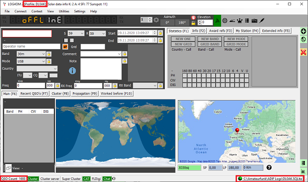

Paul, read my post and i hope you have not deleted the older "Portable" directory at your
PC. It´s fully simple to copy the whole new folder into the directory where the old one is
or the complete content which is in the new one into the older one.
This is screenshot of the portable version for DL0AK:
