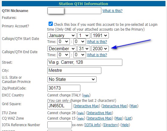

A few days ago I realized, and I'm not the only one, that the exchange of e-qsl to and from the e-qsl site has stopped.
It is not a problem of LOG4OM but of the setting of the service termination date set by e-qsl.cc.
It is probably due to the renewal of the graphics of the site but many have found themselves with the date "END DATE" indicated by the arrow on december/31/2020.
It is sufficient to enter the site (my accounts> profile) and change the date bringing it to a future deadline.
73, Giulio I3LTT
