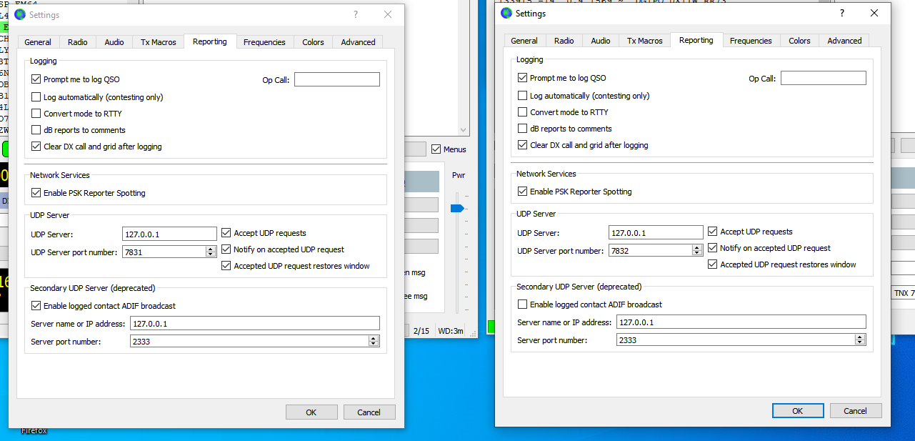

I have installed and configured V2 with no relevant issues and so far it was worth the wait...congrats!!!vThere is only one thing I haven't been able to do, and that is to populate the Qso info directly from WSJTX (I got to log directly from Wsjtx all right).

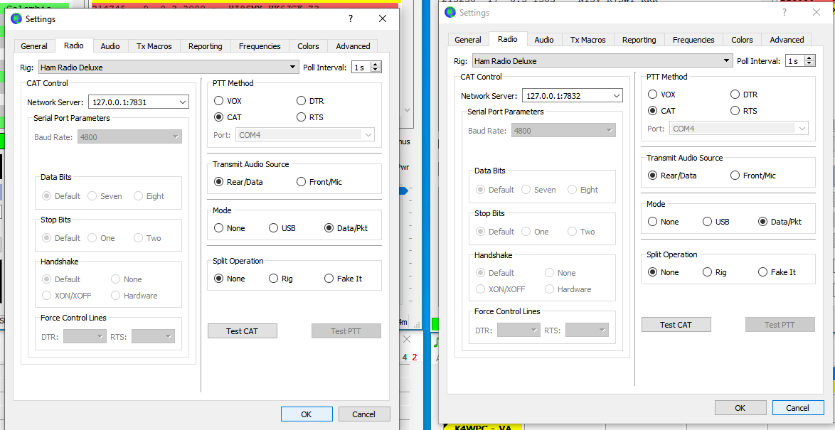

Here is the set up: I run a Flex 6300, with SmartSDR V3, Slice Master, Wsjtx 2.1. and Omnirig. When I open Log4OM it connects to Flex on COM4 and it works fine. But whenever I open Slicemaster to do Wsjtx on 1 or 2 slices, WSJTX takes Radio as Ham Radio Deluxe in both slices and assigns them Networks Server 7831 and 7832 respectively. If I choose Omnirig as radio then both slices become one and I loose the capability of operating 2 different bands/freq. These same ports (7831 an 7832) are assigned to the UDP Servers (instead of 2237). If I change them to 2237 they go back to 7831 and 7832.
As a result I cant assign UDP 2237 to JTMessage according to the Manual causing that no info is passed to Log4OM until the QSO is loged. No look up, no worked before, etc.
Therefore if I choose Omnirig on Wsjtx I loose the second slice, I have no info passed to Log4OM and cant use UDP 2237.

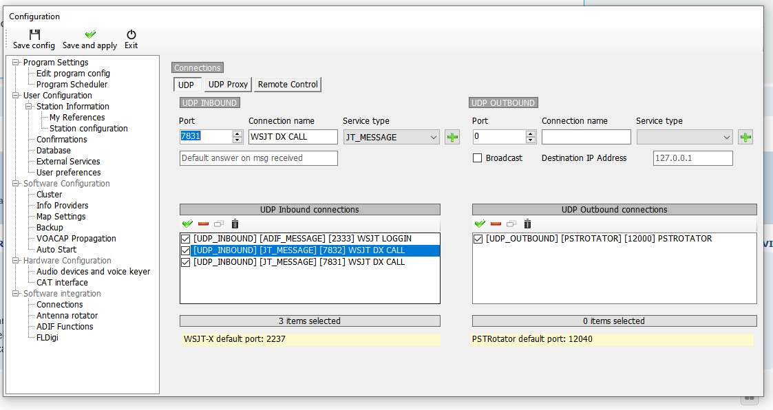

Re: Flex Multiple Slices + Omnirig
Thanks for replying. Indeed I was trying to set the UDP ports following WSJT's ports (7831 and 7832) but I get nothing on Log4Om. Some screenshots are below.IW3HMH wrote: 16 Jan 2020, 12:20 Log4OM is not bounded to a specific port in any service.
If you can change the port in WSJT, simply tell Log4OM to listen to that port.
Port numbers are reported in the manual because they're the default but you can open UDP channels on port of your choice
UDP INBOUND
Port: 7831
Name: WSJT DX CALL
Type: JT Message
And the same for 7832. Meanwhile 2333 for Login directly is working flawlessly.
I´m pretty sure is something on my end and not the program. Will keep investigating.
Thanks,
Santiago

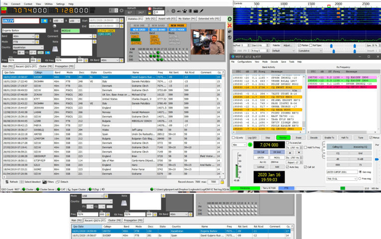

Port is 2333 not 2323 and I just checked and it works for me both look up and QSO Add, with those settings, see screenshotEI2GLB wrote: 16 Jan 2020, 20:23 That is on post 2237 which is logging the QSO's ok

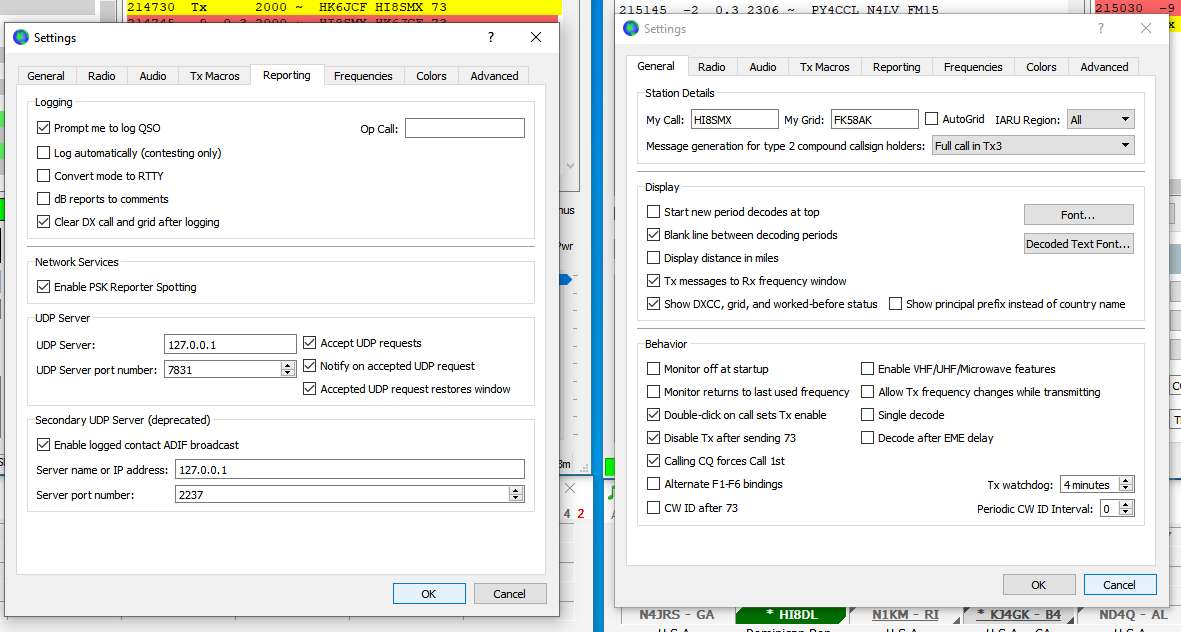

Then I must be doing something terrible wrong on my end, because it´s not working for me.
I can log directly from Wsjtx thru port 2237, in both slices (A and B) opened by Slice Master. But when it comes to populate the QSO window I get nothing from Wsjtx. I ´ve tried changing udp ports but nothing seems to work. Because I open multiple instances of Wsjtx using Slice Master it assigns them UDP ports 7831 (slice A) and 7832 (slice B) and even if I change them they come back to those numbers.
Then I tried to create the udp connection (JT Message) using those 2 udp ports numbers, but I get no info sent to Log4Om. See my current configurations on pictures below. Please note that I cannot change the radios to Omnirig, because then I will loose the multiple slices capabilities of the Flex. I know that the reason must be related to the multiple slices.
73, Santiago
73, Santiago
