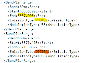

Hey gang, I've figured this out. I'm sure Daniele has too but if you can't wait for the update in a new release, here's what I've done.
The issue is in the bandplan xml document. I'm in the US so the document that affects my bandplan is Users\<probably your name>\AppData\Roaming\Log4OM2\bandplan\bandplan_dxcc291.xml
In that document you will find the following:
Orig 291 bandplan.png (12.58 KiB) Viewed 6043 times

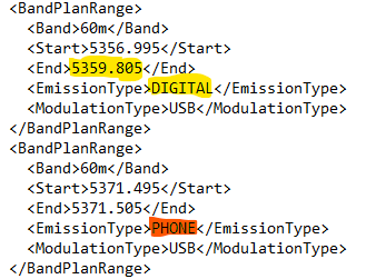

In the 60 meter section you will find Channel 3 (hi-lited in yellow) defined as a PHONE frequency from 5356.995 to 5357.005. You will also find Channel 4 (hi-lited in orange) defined as DIGITAL with a similar frequency definition.
To fix this problem, edit the .xml to this:
Changed 291 bandplan.png (12.75 KiB) Viewed 6043 times
Channel 3 is changed to DIGITAL and Channel 4 to PHONE. I use JTAlert in conjunction with WSJT-X and the logged QSO frequency is the dial frequency + transmitted audio frequency. So I have changed the band end frequency for Channel 3 to 5357 + 2.8 Khz or 5359.805. I don't know why the additional 5 Hz is in the bandplan documents but I stayed with that convention.

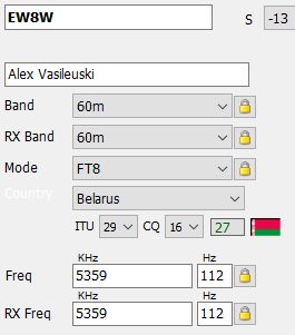

Now when I edit a QSO I see this:
Log entry.png (10.74 KiB) Viewed 6043 times
Also, the ! with a red triangle around it on the main UI is gone when I transmit. I just used Notepad as the editor and of course saved a copy of the original .xml before starting.
