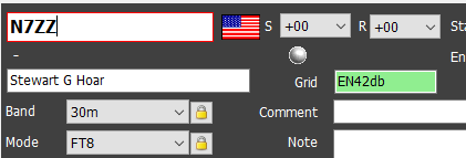

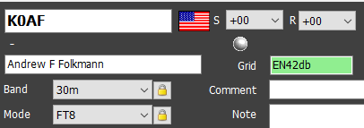

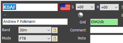

Tonight I discovered another way this issue can affect log entry. Here's a screenshot of callsign K0AF.
Note the gridsquare.
Now if I fail to work him and hear N7ZZ, I might select the original call like this:
And key in the new call.
The result is an incorrect gridsquare in the log entry. N7ZZ should be EN64bo.
73 - Tom NS8K
Posts: 11601
Re: Invalid gridsquare in main UI
If you fail to work the call the correct way to clear the fields is to use the clear (X) button or press Esc on your keyboard
