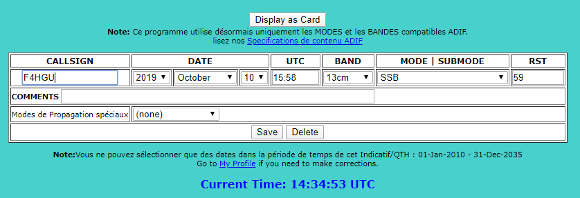

Then when I go to eQSL website the propagation mode is not detailed and I have to edit manually each contact:
Is there something wrong with my way of logging ? Or a missing parameter in the software to upload correctly to eQSL?

SX is not supported by eQSL, or i can't find it here:
https://www.eqsl.cc/QSLCard/ADIFContentSpecs.cfm
I'm adding SX to Log4OM list for everyone but i think in that case the issue resides on EQSL side

some good and some bad news. The first problem was that PROP_MODE = SAT was not exported
to ADIF. This is fixed in the next release. The bad news are that eQSL not accept this PROP_MODE.
They say that they using strictly ADIF 3 but in this case they use the description "Satellite" instead
of the real enumeration SAT.
But not a big deal i think. The lost PROP_MODE will be exported in next release and for the mistake
at eQSL i have opened a support request in the eQSL support forum. Hope they can fix before we
run out the next release ....
