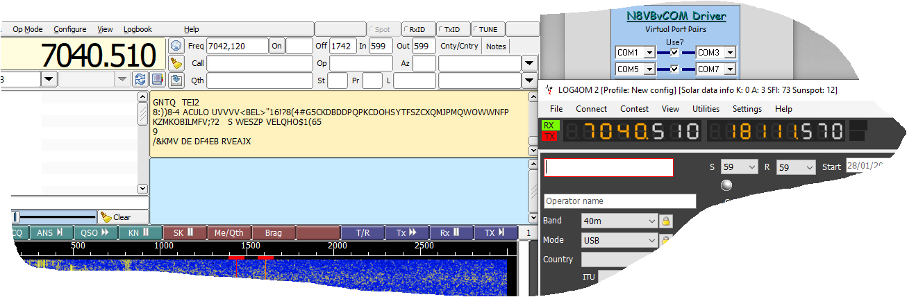

just spend one week and read doc and updated but always nothing in tx...i run icom 7600 (hexa 54 and not 70) omnirig, i split com 3/com 1; i follow all infos..nothing..for a beginner its impossible ..i use log4om since 4 years , the version before seems more easy to connect tx..
so i have omnirig, same freq on log4om and fldigi, rx is ok..but in tx..nothing.. what parameters should i look at ?
thank in advance
73 Eric

F1SMV
Posts: 42
Joined: 15 Mar 2014, 18:33
Re: always no tx fldigi & log4om
Post by F1SMV »
Bonjour Roland , Tom, and Ik0TIX
thank for your quick answers :
-to IK0TIX thank info , but i like challenge even i must stay 3 months hi..(i remember to run nextion screen & raspi for dmr i spend 1 month fo a little prob..) and i like this soft and news developments but when its hard its correct to say the true. I think help authors who are in her work (free) and can help beguinners.
- to Tom : i download 7600.xml , but i think i must change hexa cmd (but for the test i back to 70 , without sucess..54 is the icpw1 amplificator hexa adress so i must put same in icom 7600..). I will put DTR too follow your tip.
- to Roland : yes freq is synchro between log4om, trx and fldigi, its ok
i use N8BVvCom (2005 ) which is old but seems run ..i test too vspe32 (without more sucess, hi)
Good day.
Eric

GE all
Icom run on com 3 on omnirig
fldigi ..tonight strange ..freq is synchro but in fldigi nothing is checked, neither flrig, nor cat (rigcat), nor hamlib, and yet the frequencies are synchronized !
amazing hi...I do not know what to think anymore..
73 Eric
Posts: 11601
Clearly the xml/rpc connection has been set up in log4om config
