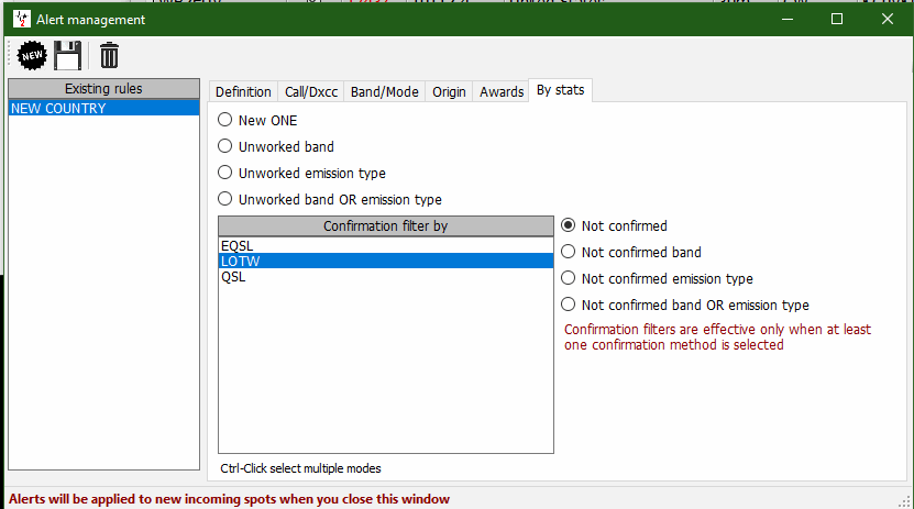

Re: cluster alert no populate? on 2.3.0.0
Terry,
In config below, my Alert does not work unless its unworked.
I can test spot a country that is worked but no LOTW confirmation and do not get the alert.
If I test spot a country that I have never worked I get an alert.
Do I have settings wrong? I originally had it on new one and have tried LOTW filter
Rich
