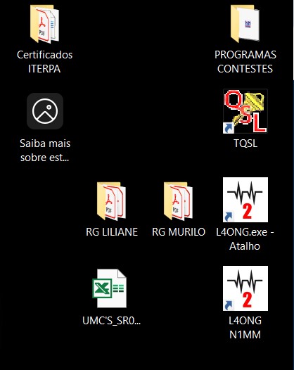

Captura de tela 2025-05-05 005348.jpg (35.35 KiB) Viewed 1100 times
Night Dear's
I think I'm doing something wrong because I create the "clone" and create the shortcut on the desktop, however when I access the shortcut "N1MM" it loads correctly, without activating the CAT and with the File right at the top of the program (N1MM).
When I open the other shortcut (NextGen") it loads with the same ID / configuration ( file N1mm).
In other words, in practice there are two shortcuts for the same configuration.
What could I be doing wrong, because I followed the step by step rigorously?
