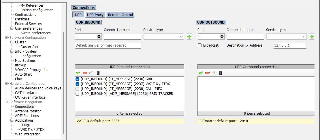

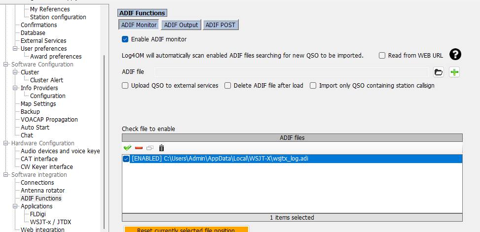

3. When I log a contact in WSJT-X that will be sent to GridTracker and Log4OM etc. as mentioned but when this QSO is logged while Log4OM is not running and I open Log4OM I do not see this contact in the log (recent QSOs), what is the correct setting for this and will this be synchronised automatically then? (I have already enabled the ADIF Monitor and linked to the WSJT-X log as you can see in the screenshot). Somebody told me that it has to be set up in the connections tab, but how?

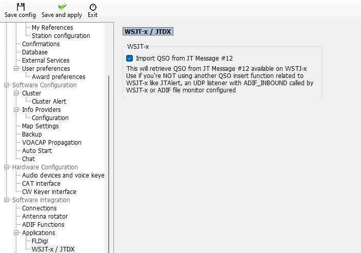

4. Is it safe to set "Import QSO from JT-Message #12" and what does this stands for?

Stefan,
Quick glance at your question(s) and screen clips appear that you are picking/choosing, but have not taken the time to review the Current User Guide. Starting on Page 210 of the English version of the guide is the discussion of integrating the JT Programs.
Following those steps (carefully) and you should be in good shape.
There is also a YouTube video relating to additional information about JT Integration.
One question I'll answer is that if you are logging Q's via Gridtracker when Log4OM is turned "off" then there will not be a record of the Q in the Recent QSO's (F7) tab.
Also doing double uploads to LOTW will also get you in trouble over time with the LOTW folks. Maybe not so much for an occasional duplicate, but if you then upload a huge amount of Q's that are dupes you could be locked out of LOTW for a small span of time.
Also ... when it comes to LOTW make sure that you are using the most recent version of TQSL. It was just updated in the last week as I recall.
