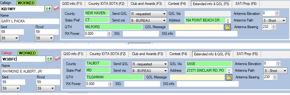

What is strange is that this does not occur with very station. Look at the attached screen shots.
KB1WY is in Milford CT, and it shows the heading of 232 - which is "long path" from my QTH
W3BFC is in MD, almost due South from me and it shows the correct beam heading.

Both call signs provide a correct heading from my QTH of 288 degrees short path
What locator is displayed for each call when you enter them? Check it against the locator displayed on the QRZ lookup/detail tab
My guess is that your not getting a locator returned from QRZ so we then resort to providing a locator which is the centre of the country that would provide a westerly heading from your QTH
