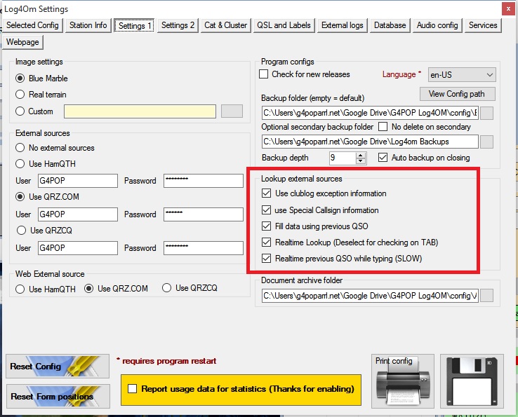

What version of Log4OM are you using and do you have all the settings 1 check boxes enabled as below
Re: Lag when typing in callsign field
I have 1.24.0.0. I currently have all of those checked, but I have tested with with all of them off, and I don't notice a difference in speed either way.
