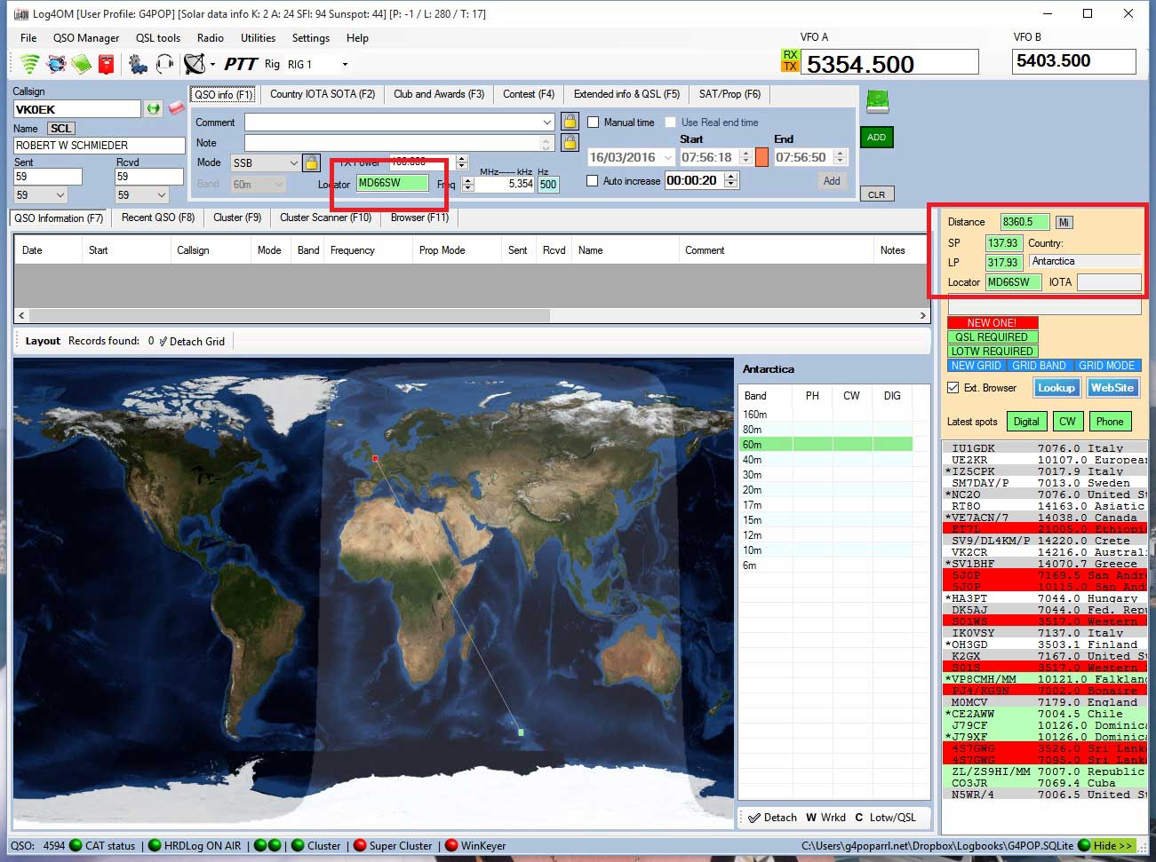

Evert,
My guess is that you did not have the correct grid locator either from your online lookup or manual entry, see my screen shot below

Re: QTF Heard Island
Hello Terry,
Thanks for the reply.
If I read your first answer I conclude that the QTF is only based on a QTH locator and not on a DXCC when the locator is missing?
(I would suggest first reference would be the locator but when missing based on a DXCC, probably less accurate but better then nothing).
73's, Evert PA2KW
73's, Evert PA2KW
