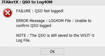

I have a problem that I have been unable to fix. When I finish a JT65 QSO and tell WSJT-X to log it, I get an error message telling me it has been logged in the WSJT-X program but not in Log40M. The logging program seems to be connected as it follows the frequency and both little communication buttons at the bottom of the screen are green. The logging program also seems to be talking to the other programs – JTAlertX knows if I have already worked a station, if the station is needed for WAS, and so on. I have uninstalled everything and reinstalled everything twice without fixing the problem. I think I must have obviously missed something important, but I cannot figure it out what it might be. I have even done the most unlikely on ham thing and use the instruction book to install the program – grin. Below are all the programs in use and the rig. Thanks in advance for your help.

Have you checked Log4OM to see if the QSO was logged? Sometimes the error message shows up, even though the QSO was logged. If this is the case, try this. In JTAlert, go to Settings/Miscellaneous/Performance and increase the time under Check QSO Log Record. I have mine set to 10 seconds.

Thanks, it is not logged and the automated updates to other logs also was not done. With everything else working, it is very frustrating not to have the automatic log feature working.

It is likely you have the incorrect path and file name to your Log4OM database set in JTAlert. In JTAlert, go to Settings, Manage Settings, Logging, Log4OM section. There you will find the "Log Server and SQLite File path". This must be set exactly to match the path & file name which you will find on the main Log4OM window in the lower right corner.
While on that settings page in JTAlert, also check that the Server IP Address is set to "127.0.0.1" and the UDP Port matches the port set in Log4OM Communicator, Settings, Inbound, Inbound Settings - the default value is 2236. All of this is explained on pages 182, 183 of the Log4OM User Guide dated 16May2016.
