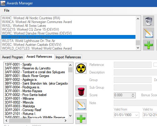

3. In Utilities/Award manager can he see a WFF : World wide Flora and Fauna award in the list?
4. If the award is listed can he see the award references by clicking on the Notepad edit icon indicated above and then selecting the 'Award reference ' tab as shown below

Yes I can see WWF on the list on the left but get no drop down menu on the right
No there are no award references when I click on the notepad icon

1. Open the Utilities/Award Manager
2.File (Top left corner of window) and select import
3. Select the silt that you saved to the desktop - Click 'Open'
4. Click the save icon in awards manager (Its the black floppy disk)
5. Close the awards manager
6. Restart Log4om
Let me know if you can now see the awards reference list in both the awards manager as described before and also in the 'Club and awards tab (F3)
