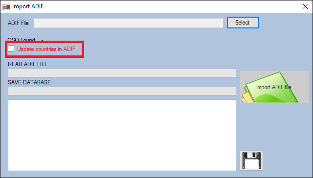

have you imported your Logfile from an ADIF ?? If yes, have you checked the "Update
countries in ADIF" Box ??
If not delete the created database, create a new one, open it via the File menu
in Log4OM and do a fresh import from your ADIF with a checked "Update countries
in ADIF" box. Close Log4OM after importing the ADIF and restart it. Log4OM should
now start with the new Database. In Stats and Award you should see now the worked
Status for the countries you have worked.

thanks alot that did it.. I didnt check the box when i imported the first time
