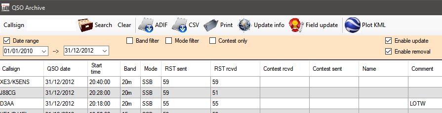

I found my logbook contains many many duplicate qsos during 2004-2010. Is there a way to highlight many qsos at once and delete them instead of having to go back to 2004 in my log, search and then delete an individual contact every time over and over again?

Yes do this in the QSO archive manager by selecting a date range to search on and enabling the two check boxes for update and removal as illustrated below.
Highlight the unwanted entries and press the 'Del' (Delete) key on your computer keyboard.
See the Yahoo tutorials for more information regarding the QSO manager and many other log4OM topics here: https://www.youtube.com/channel/UC6Ppcj ... yavI-azOug
