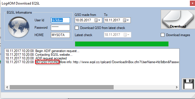

I have 3 accounts on eQSL, but LOG4OM can only deal with one of them.
If I try to download from Bero, all is ok. When I try to download from either MYSOTA or SOTADL i get NO QSO FOUND. But be ensured there are lots of QSO's in the 2 eQSL Profiles / Accounts.

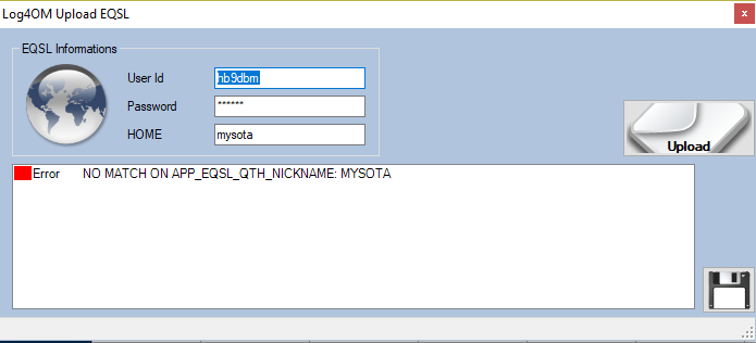

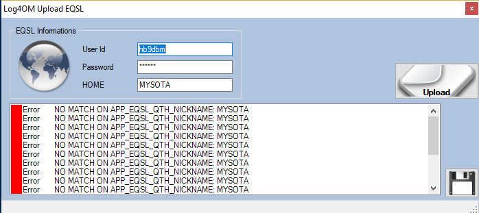

When i try to upload to one of the 2 accounts, i get another error message:
I ran out of ideas how to fix this.

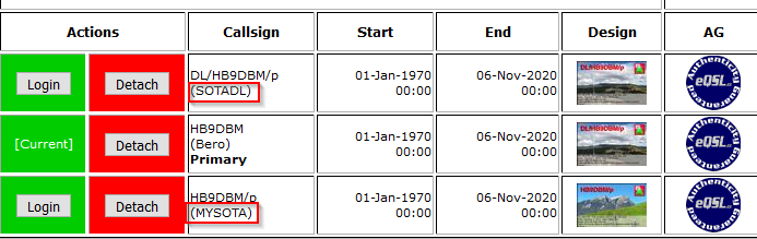

Also renamed the QTH Nicknames to lower or mixed Case, unfortunately also without success... (gets converted to UPPERcase again....?)
Nicknames on eQSL look like this now: Any other ideas? I'm pretty sure LOG4OM does it not handle correctly.
or should I contact eQSL.cc ?
Mark
But none of those worked.
Tried with different LOG4OM Profiles

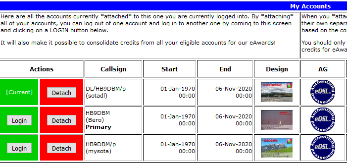

OK got it working now.
It was a typical user failure:
I didn't realize that you have to login to eQSL with the corresponding Call (i.e. DL/HB9DBM/p) but always with the same password.
Thanks to all for your replies.
