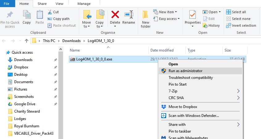

Just now tried it again from the point of downloading the file. From the folder where the file is saved I see No option for " open as administrator" when I right click on the downloaded file.
My apologies.. I always open the log as administrator so the cat and cluster etc. work correctly. But there is no option for open as administrator when right clicking the Log4OM_1_30_0_0.exe file.

AFTER you have unzipped the download file you will find this when you right click on the Log4OM_1_30_0_0.exe file.

I found the file, same location as you show on the illustration. Unzipped .exe file. Right click and choose Run as Administrator. Says adding files from a log4om enu.pdf file, goes to installing.. Removing files, and stops with that 183 error code. Tried here again to manually remove the file and I get a file access denied. I need permission to perform this action. ???
