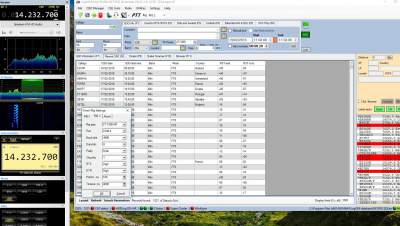

Hi Terry .... I must be losing the plot. I have deleted the 19/20 vspe pair and reverted back to my FT1K Omnirig settings. SDR console is talking to the FT1K no problem. I then run log4om then tick CAT control when omnirig comes up detailing the FT1K connection details, I then click OK but it still wont show the frequency etc in the top of the display. The CAT status stays red at the bottom. For whatever reason omnirig is not multithreading through to log4om. My SDR is an SDRIQ.

Hi Terry... well that old egg certainly bit me in the bum. Nothing is mentioned in the manual about running SDR Console or Omnirig in Administrator mode. Log4om, yes it does specify running it in Administrator mode. Having changed the properties in the short cuts to run as administrator voila everything talks. Thanks. Perhaps you can answer this for me. Why in the manual does it have details of running a pair of VSP so that SDR Console can talk with log4om page 190 when in fact it can clearly talk via Omnirig and finally why does the software log4om, sdr console and omnirig all have to be run in administrator mode ? apologies to the experts if these questions appear basic.
