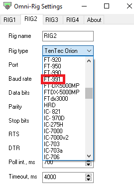

On the Omnirig download page you will find also the rigs. Download it and copy the rigs
to your Omnirig Rigs folder. After next start you´ll find the 991 in the Dropdown
Don´t wonder about the 4 Rigs in Omnirig, i use the Omnirig 2 project but 4 Radios are not
supportet yet in use with Log4OM V1. Maybe on a later V2. So you have normally the original
OR with only 2 Radios to setup.

SUCCESS !
You guys are good ! The last time I tried Omnirig, Log4OM could not find the radio. I have no idea why?
This time I clicked on Omnirig, clicked on save, closed the software and then even rebooted the computer. Maybe a little overkill, but it worked. Opened Log4OM, and clicked on the headphone icon to bring up the rig settings. This time a different window opened and I was able to set up the FT991A.

Re: Yaesu FT991A CW/ telnet issue
Problem solved as stated in my above post. BUT, what you showed me is what I could not get to open before. That was the problem. I have no idea what was wrong or what I did wrong. I love the idea of being able to use more than one radio without always starting from scratch with the rig settings. I'll use this laptop in the primary station and portable. It will be configured with three other radios.......and now I can do just that.DF5WW wrote: ↑01 Mar 2019, 18:26 On the Omnirig download page you will find also the rigs. Download it and copy the rigs

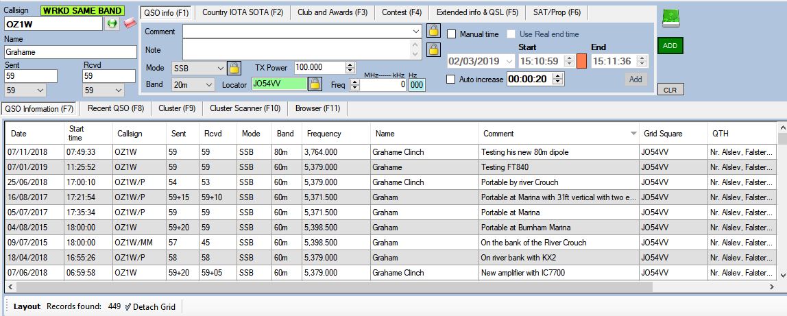

I don't have a problem, but I do have a suggestion:
In the recent QSO (F8) window, add a column that shows comments.
I always add a comment to each contact, like power used and antenna used.
It also shows if I made the contact in a contest which I just entered to give other hams some points. I may also state when it's long path.
This is not a big deal for me but I think it would be nice feature.

Select LAYOUT and add the comments column or any column of your choiceku3x wrote: ↑02 Mar 2019, 14:38 I don't have a problem, but I do have a suggestion:
Oh Boy ! That's perfect. I did not see that. It's hiding on the bottom of the screen.
Maybe I should use my good eye. Hi Hi
Now I can make changes that I did not know I could. This program keeps getting better everyday !
To the right of the recent QSO page is a lot of wasted space. How can I widen the window so my comments column is much wider. I see in your picture the recent window uses all of the space, no grayed out area to the right.
Barry
Page 53 of our user guide describes how to adjust column widths, change layouts and change column tittles
Most features are detailed in our user guides and these guides are searchable, so for instance search the word 'Layout'
