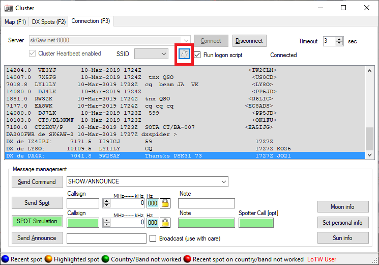

If you like to use more filters you can do this in the cluster (F9) window. If ther´s not enough filters
you can use special cluster commands in the logon script by editing it.
You find this option if you open Utilities(Cluster ...

Apply a filter command to the cluster provider which allows only spots from a spotter in your DXCC entity
See here for filter details http://wiki.dxcluster.org/index.php/DXS ... ing_Manual
And refer to the Log4OM User guide or video tutorials for how to send commands to a cluster server
