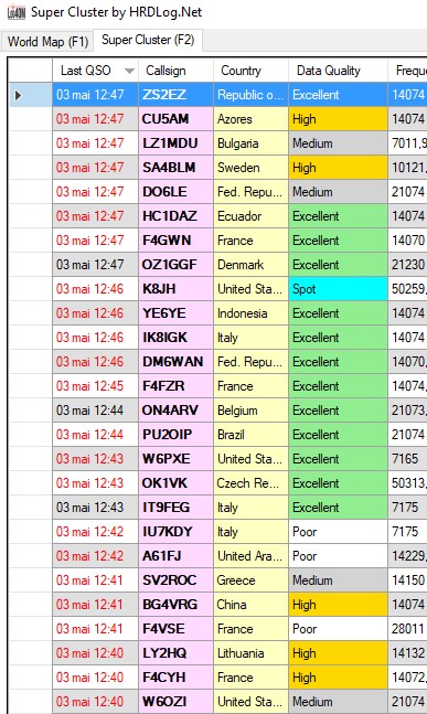

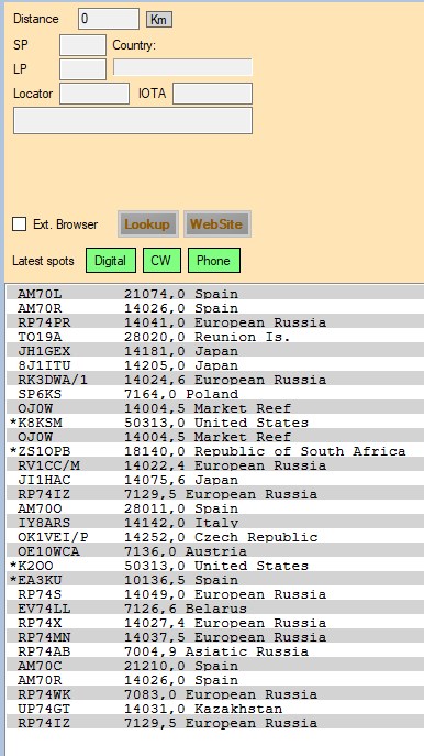

I'm still testing Log4om and I have some questions about clusters
1) what does * mean in the cluster here
2) why I do not see the same thing in the "simple" cluster and the "super" cluster
For example on the "super" cluster I see
ZS2EZ ; CU5AM etc ...
but I don't see these calls on the "normal" cluster ?
I read the documentation (in French) but I don't see some explanations about that
Thanks for your help ...

Re: Cluster and super cluster
Because the "simple" cluster is the raw data received from the selected telnet cluster while the super cluster is a COMBINATION of data from HRDLOG and the telnet cluster
Terry,
Can you explain
"Because the "simple" cluster is the raw data received from the selected telnet cluster while the super cluster is a COMBINATION of data from HRDLOG and the telnet cluster"
If I do not check the show data from HRDlog.net box on the super cluster I would have assumed that the remaining spots would match the regular cluster. But it does not.
Not necessarily because some of the raw spots may be older than the age set in Log4OM, from memory I think we only display spots in the cluster window that are younger than 30 minutes.kd0zv wrote: ↑13 Dec 2019, 13:39 Terry,
Can you explain
Rich
Secondly some spots may be grouped so if G4POP was spotted three times when grouped only one entry will be displayed in the main cluster although all three will be in the raw data and information about all of the occasions that I was spotted are available by hovering over the spot with the cursor.
Finally of course you may have filtered spots in some way by using the built in filters in Log4OM
Well I am still lost.
I can change my cluster address to my local 127.0.0.1 which should be just CWskimmer. I do not have the box checked for HRDlog.net and I am getting spots from all bands and all modes. So it its not coming from HRDlog.net and not coming from my local host I am curious where it is coming from.
