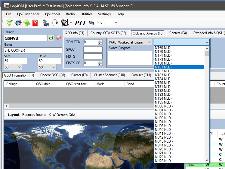

Works for me, see screenshot below.
I suppose that you have entered a UK call sign?

Yes, I am using 'G' calls and specifically used the one in your screenshot Terry, but to no avail (QSO Info (F1) set to 20m SSB).
