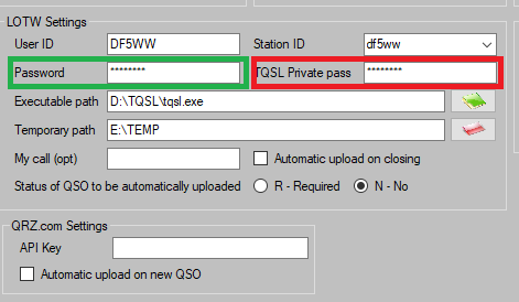

Please check Settings/Options/External Logs .....
You can set 2 passwords in the LotW settings. The green marked one is the must have password
and it contains the login password u are using for the login to the LotW page.
The red marked is the private pass you have set (if you do so) when you received the certificate
from the LotW and you have implemented it to the TQSL Software. TQSL asks you will set one
or not. If you don´t have set one this field can be stay empty.
If you have set a private pass it has to match exactly (e.g. uppercase or lowercase letters).
