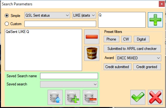

For now you can use the 'Search Parameters' at the bottom of the label print window as shown below to locate your queued QSO's and the rest of the label print operation will work as normal

That works for selecting them now.

Label Printing provides some parameters in the top area of the screen.
Those parameters are QSL SENT and QSL SENT VIA
Parameters are provided to the internal search engine that extracts the records with the required informations.
Both parameters are passed with "AND" logic
So, as example: QSL SENT = REQUIRED AND QSL SENT VIA = BUREAU
If you add another filter at the grid level (using search parameters) you are adding more parameters to the provided list of parameters.
if you add QSL SENT in the search parameters = Q the result query will be:
search all QSO where QSL SENT = REQUIRED AND QSL SENT = QUEUED AND QSL SENT VIA = BUREAU
First 2 params will "broke" the query, because no QSO can have QSL SENT = R and QSL SENT = Q at the same time
If you want to use search params you should leave the first dropdown list empty in the label print first page.
This will then not conflict with search parameters, if you select the same field in the search params screen.
