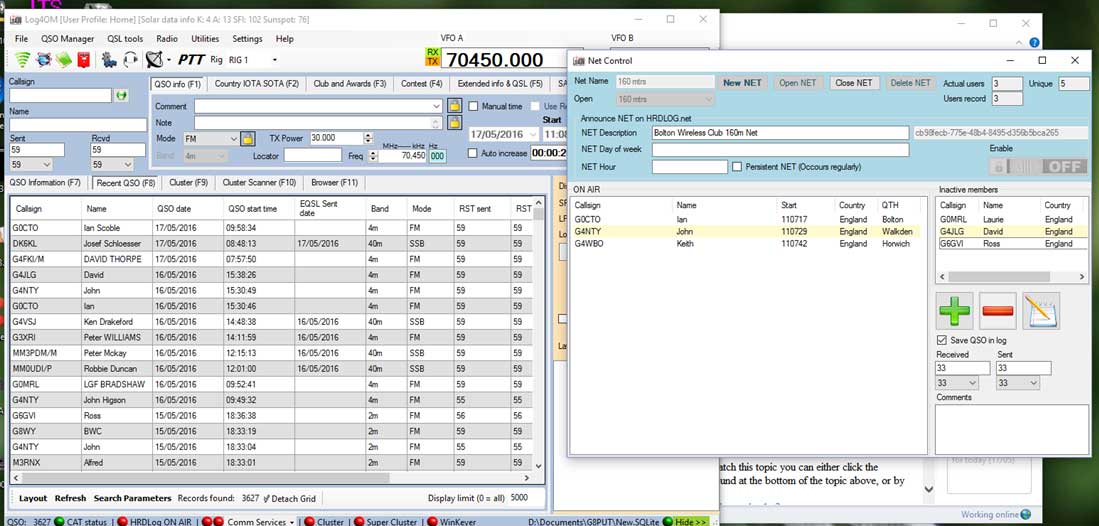

Hi I have taken a good look around and have not been able to find an answer to a question about adding members of a net.
I'm using the Net Control part of Log4OM and its working well, I'm just trying to sort out how I record individual RST reports as they all seem to record the same RST. How do I record individual signal reports?

I have tried setting the RST before adding them to the Net as per your relpy, however either right clicking or dragging the call back to the right hand list whe they leave the Net the RST always defaults to what is set in the Received / Sent boxes at the bottom. Strange

On my version 1.25.0.0 the Net Control seems to log the contact with the Signal Report that was last used and than once the contact leaving the net has been moved out his initial report is changed to the one last used and then the Signal Report options then default back to 59 59

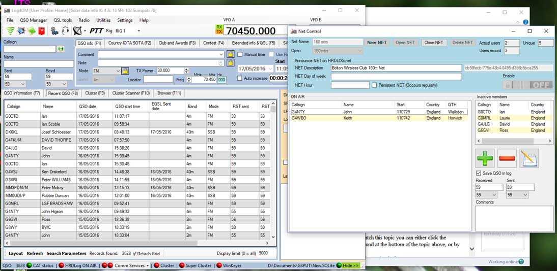

They are G0CTO signal report 55, G0MRL signal report 44 and G4WBO signal report 33
All looks ok and showing 33 and 33 as the next RST unless changed, now when G0CTO is logged out the main log now shows his RST as 33 33 not 55 55 as selected when added and notice that the RST has now defaulted to 59 59 and any other call signs are than logged out as 59 59 not 44 44 for G0MRL and 33 33 for G4WBO
Hope this make more sense

So what you are saying is that as someone leaves the net although their RST is recorded correctly all previous QSO's for that net which were initially recorded correctly and QSO's saved afterwards revert to the default RST?
Now I understand the issue and it something that I had not noticed before!
It should work as described so its something to do with the method of saving the QSO
I have moved this thread to the error reports thread and added it to the Mantis list

Re: Net Control / RST
Actually the signal report that is shown when you drag out the callsign is used to save the QSO.
It's something you set when removing (and logging) and not stored on the callsign itself during his "active life" on the left side.
I'm removing the "reset to default value" when a QSO is removed from active list.
This should preserve the value set also for subsequent qso's until changed
