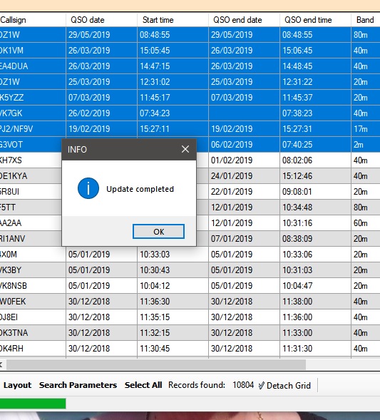

Most of the updates are done automatically as the QSO's arrive from N1MM but I just checked anyway and the update progress bar and end notification are working here in V 1.37 on Windows 10 machine, see below.
Re: Log4OM Ver 1.37 N1MM and Update Info
HI Terry
Yes I agree, I see that on mine too, but I thought that when you clicked on Update info it would update Country, name etc. Is that not right?

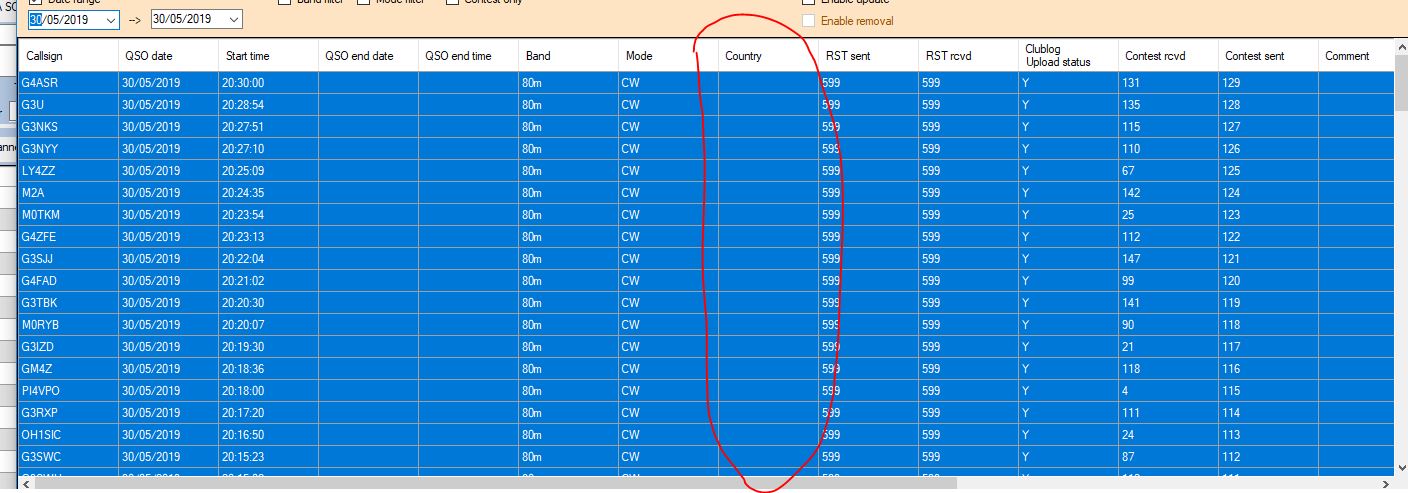

Well for example, I have just finished the 80m CC contest, and these are the QSOs I have just completed on N1MM+ and they have passed through to Log4OM prefectly.
So now I have selected them in QSO Archive, and clicked on Update info. I am seeing the green status bar at the bottom left, but the Country field is not filled in after the update is finished. I was expecting the Country field to be filled in.

Ok go to field update and select verify country from call sign, then execute it
This is because N1MM does not send the country or the dxcc number
Ah thanks, that worked. I thought the Update info would do it but will remember that option.

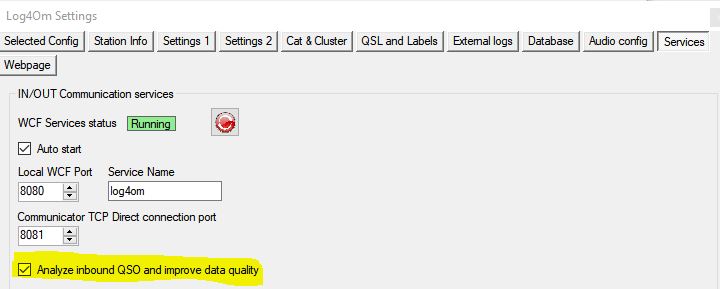

I am puzzled why we did not update the country and DXCC when the QSO was received from N1MM
Can you please check that the Options/services check box for 'Analyse inbound QSO and improve data quality' is checked?
