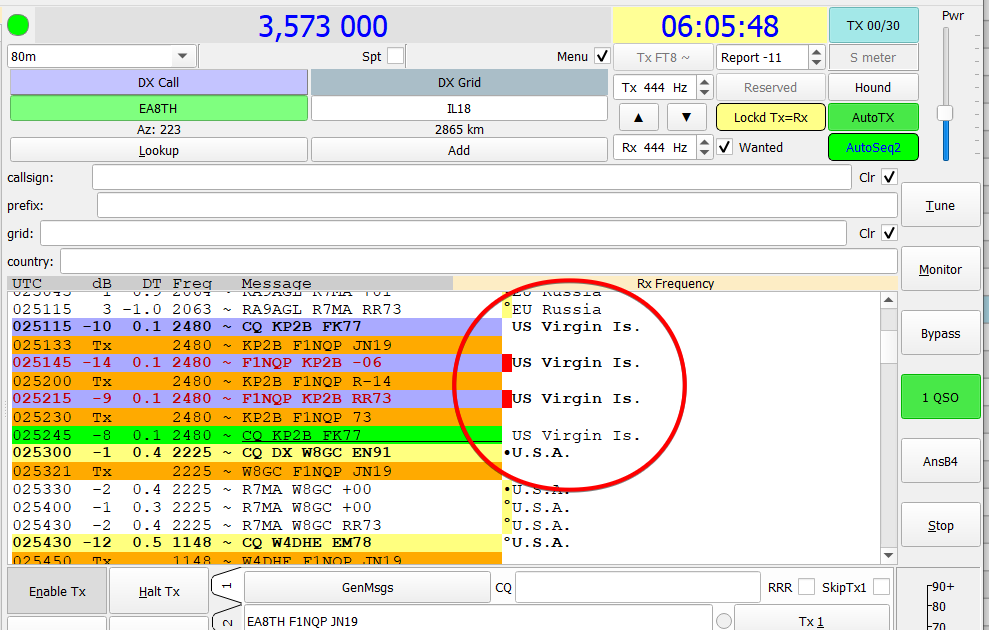

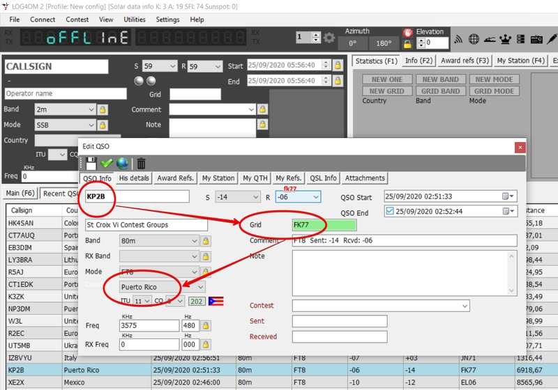

This morning I contacted KP2B in FK77 which is on the Virgin Islands, it is well recognized with JTDX, but in LOG4OM2 it turns into Puerto Rico.
How to change the Country in LOG4OM?

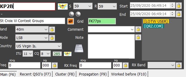

My guess ism that you have not updated your country and clublog files in Log4OM because it works fine for me, see below
You can change the country in the QSO edit window

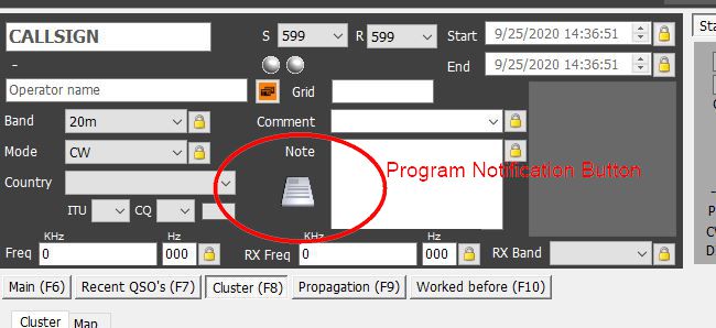

The updates (once you requst them) happen behind the scenes. There is not any visual indication that the update is underway.
You can check the Program Notification button once it appears and it will have a list of whatever updates have happened. Various support files are being updated on a regular basis.
If I select the same updates to files as Terry noted and you said never happened when you did same that result of update will cause the Program Notification button to appear and if you click on that will then see what updates have been applied.
Screen clips below indicate the Program Notification button that has an update notice inside and the other clip shows what was recently updated on my installation.
