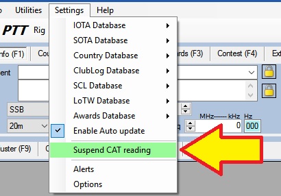

Post by G4POP » 09 Jan 2017, 18:09
Not a problem if you click on 'Suspend CAT reading' in Settings

Post by DF5WW » 09 Jan 2017, 18:12
That´s the way i do too and it works perfect ;) ;)

Post by KA4CDN » 10 Jan 2017, 11:25
It does indeed work and perfectly at that (although I can not select a band, it does it automagically). Thank you!
