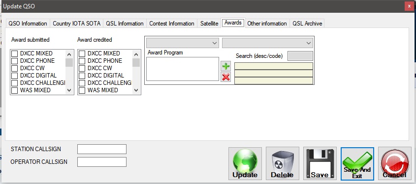

Look at the status key S in and orange box indicates that you have marked that QSO submitted somehow, check the edit QSO Awards tab and you will find a box checked somewhere
Re: Some QSOs shown as Submitted while others show Verfied
Many thanks Terry, In both cases the Challenge box was checked. Why or how that was the case I don't know, but clearing the check box did the trick.
