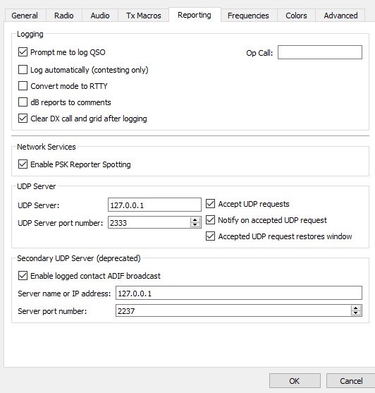

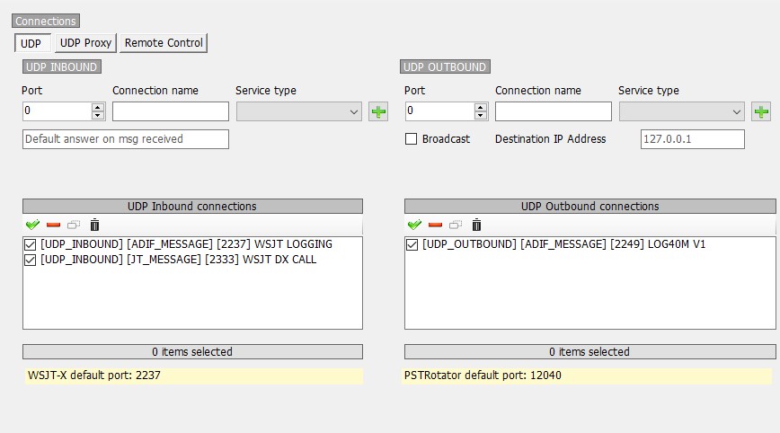

I am having a problem with getting callsigns entered in WSJT-X transferring to Log4OM V2.
I have read page 134 of the manual and followed it step by step but I cannot get the callsign to go to Log4OM
My settings are
FWIW, logging a call via v2 will show in v1 so I must be kinda on the right track.

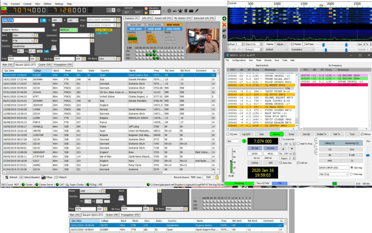

I have just double checked that it is working and here is a screen shot of during the lookup and after being logged, same settings as in user guide!

I understand the issue. The DX call field from WSJTx is not making it into Log4OM V2 Callsign field. Your settings look correct, so its something else blocking the UDP messages. I have the same settings and it is working fine here.

Like VK7YUM I have tried everything to get he DX call field from WSJTx making it into Log4OM V2 Callsign field. I can see with David's settings, in the user guide the secondary UDP should be port: 2333 and the UDP Server port: 2237. David's are around the other way. I don't think this an issue? I have tired both combinations and no matter what I do when i select a contact to work in WSJT-X the call sign is not passed over to Log4OM V2 for lookup.
