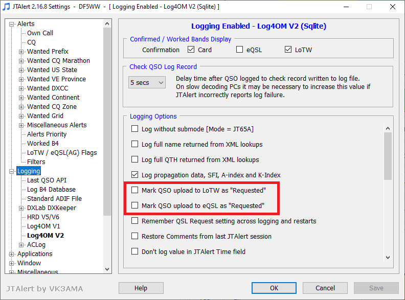

Did you use JTalert with WSJT-X ? Have seen also a problem here with wrong entries in eQSL uploaqd statusnigelspear wrote: ↑03 Jul 2020, 18:01 The only JT program I use is WSJTX. As far as I can see there are no options in WsJTX that relate to this?
and for LotW it was the same. The problem was a wrong setting in JTalert. Checking the 2 boxes will send
"Requested" to Log4OM.
By the way, to change upload status for eQSL, LotW and others use the QSL Manager. Much easier.
