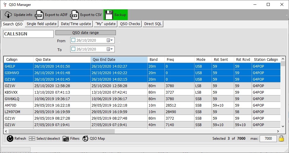

Firstly I assume that you have selected the band and mode in the net control window and clicked the padlock to lock them as below?
That way the band and mode are saved with the QSO
Then using the QSO manager select and highlight all the qso's for the relevant net that have no frequency as in the image below.

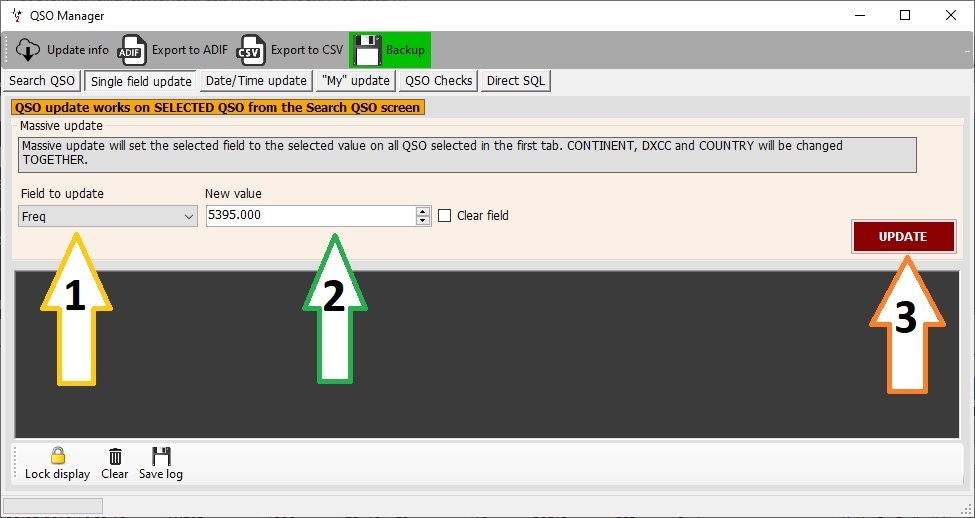

Now go to the 'Single field update' tab and.....................................
Select 'Frequency' in the drop down marked 1
Add the value in the box marked 2
Finally click the update button marked 3
