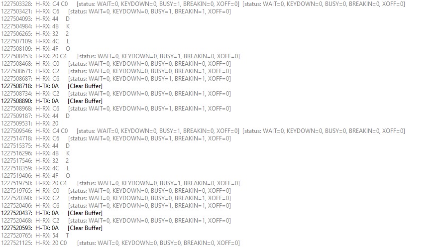

With LOG4OM the Winkeyer Communication Log shows "CLEAR BUFFER" message always when the problem happens with LOG4OM Winkeyer option and Paddles are stuck:
It would be great if this problem could be solved. Other programs can do it - it is a pity that LOG4OM cannot. Perhaps it is just caused by some buffer overflow??

The "CLEAR BUFFER" situations I observed, only occur together with the paddle issue of LOG4OM. I never noticed this with the other programs which are working fine.
Isnt it a good hint to start debugging here. The buffer handling of the winkeyer interface in LOG4OM might be the reason for the fault.
