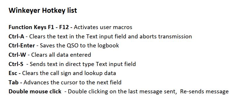

I've just checked the latest user guide (updated a few days ago) and the ESC key is listed as follows:
Esc - Clears the call sign and lookup data

The keystrokes are as listed in the user guide on page 90
Esc - Clears the call sign and lookup data (Not the text to be sent)
Ctrl=A - Clears the text from the text input field and aborts transmission
Ctrl+W - Clears all data in the text input field and aborts transmission

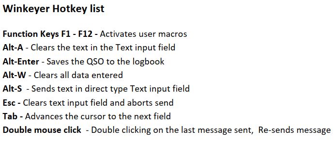

yes I can confirm that in V2.15.0.0 the ESC-key in Winkeyer unfortunately no longer aborts the transmission. I did not find in the release notes that this change is intended.
from Help menue I forced update of user manual and get on page 90: So this is different from your documentation - strange.
I would appreciate the behaviour of the ESC-key as it was before. PLEASE

User guide dated 02/07/2021 from FTP server in English shows this and this is the latest version applicable to 2.15.0.0
Other translations could be different

I used Help-User Guide-English (force update) and got the result above. After doing it again I received your version. So something was wrong with my first upgrade.
Nevertheless I would like the old ESC-key behaviour.
