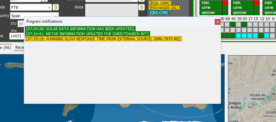

I reconfigured the UDP connections for JTAlert etc, so the automatic uploading to QRZ etc are now working correctly.
With the warning triangle for a slow connection in the final release version can this have an option to turn off please?
Internet is 1GB speed up/down here but latency etc to northern hemisphere external databases, say QRZ may have bottlenecks. Still perfectly usable.
Thanks.
Gavin
