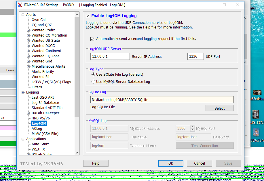

Use Omnirig with Log4OM to control the radio
In WSJT-X settings/radio select Omnirig
In JTAlert Settings/Manage settings/Logging select LOG4OM and set the parameters as below
Check Enable Log4OM logging box
Log4OM UDP server = 127.0.0.1
UDP Port = 2236
Check Use SQLite file log button
Enter the path to your Log4OM SQLite file in the SQLite Log field
Click OK

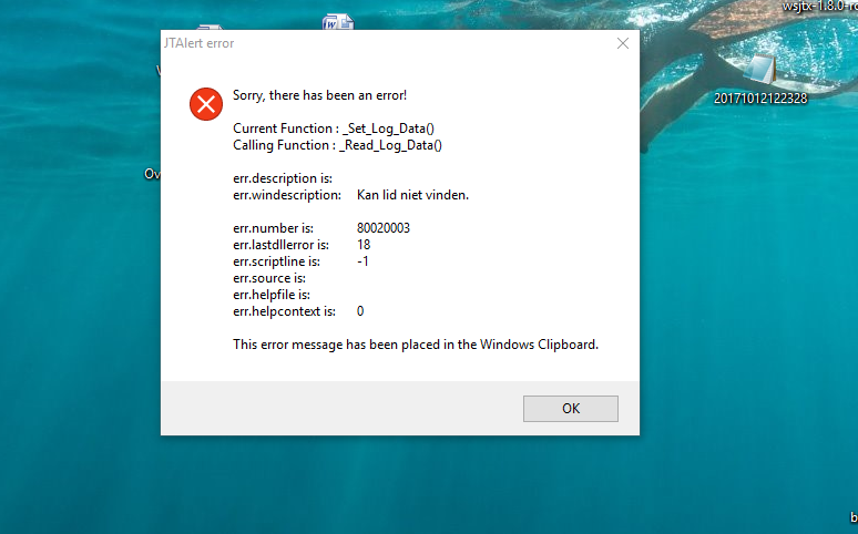

Hello Terry,
I have tested the complete setting and all works fine except the logging part.
Made all the settings you adivised, can use radio via CAT, see that Log4OM shows QRG readout, see that JTAlert shows Log4OM in title bar etc.
The only problem is that i get a JTAlert error, at end of QSO (after 73's) it takes some while and than an error occurs.
The only thing i can think of is a timing problem ???
I have submitted the screenshots from different settings. I see only 3 attachments at the time so i made a second post with rest.
73's
Gerrit

- JTAlert error.PNG (211.42 KiB) Viewed 9862 times
- Log4om settings.PNG (115.7 KiB) Viewed 9862 times
- JTAlert config.PNG (136.18 KiB) Viewed 9862 times

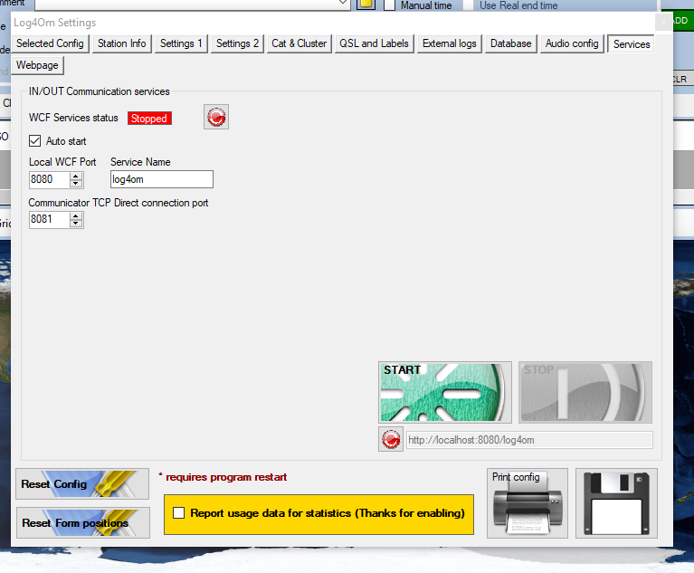

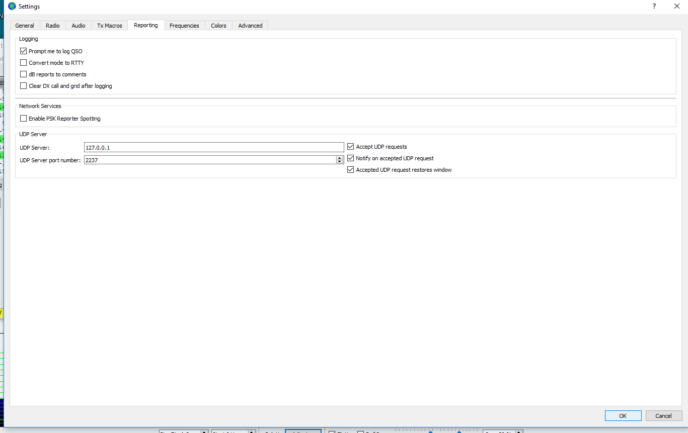

Re: Setup using VSP problem
This is my second attachment file.
73's Gerrit
73's Gerrit
- Log4OM database.PNG (137.83 KiB) Viewed 9862 times
- Log4om services 1.PNG (153.35 KiB) Viewed 9862 times
- Wsjtx udp settings.PNG (26.57 KiB) Viewed 9862 times

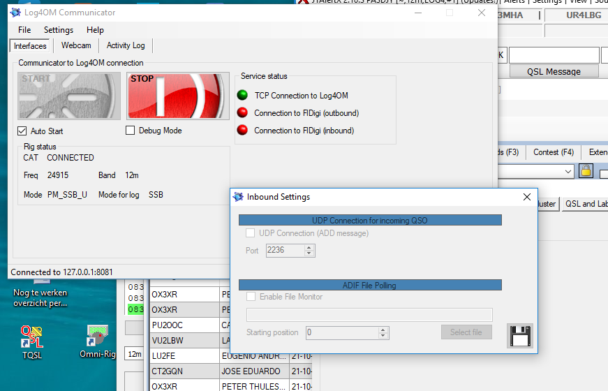

Hello Gerrit,
i see that UDP Service in Inbound setting of the communicator is disablet.
Stop the communicator and check the Box "UDP connection" then restart
the communicator and try logging again ...
