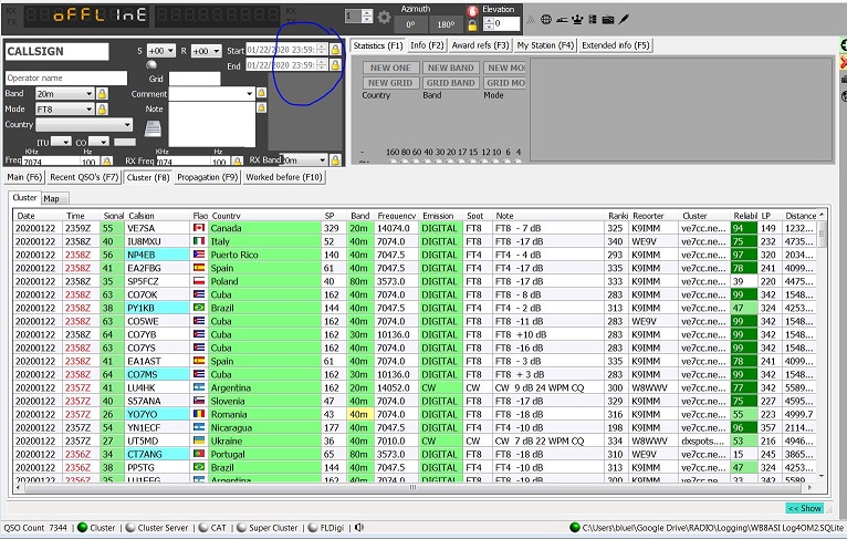

Got it in pictures.......1st shows cluster rolling along perfectly at 2359.

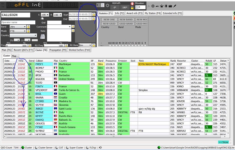

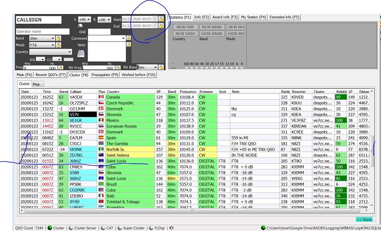

Cluster continued to run fine after 0001. I closed V2. Then reopened V2 and there was NO cluster connection. The active servers had disappeared in connection setup. I reinstalled the servers, and reconnected. The same batch of frozen spots returned with same time from a couple days ago, but now are dated 20200123. Picture at 0005.

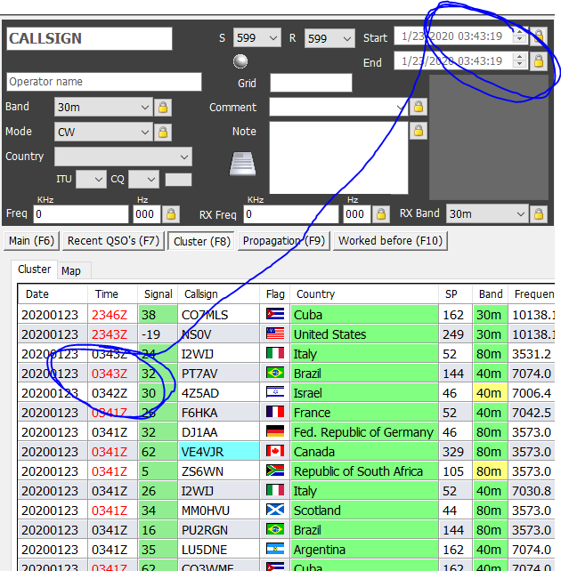

Scrolled down to bottom of frozen spots (now appearing as future spots). There are about 40 such spots. Picture at 0007.
Maybe take a look at what you had replicated, and you probably have your frozen ones back in this new day. Think this should shed a light on the problem. I know the JTAlert HamApps folks are having trouble with V2 date/time now being a single value rather than the V1 single value. Might be related. Also, why do the active servers disappear upon date change. Thanks, Herb

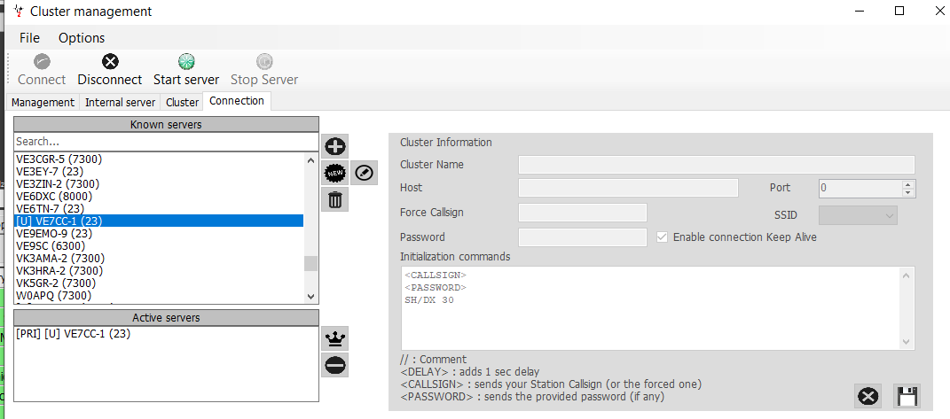

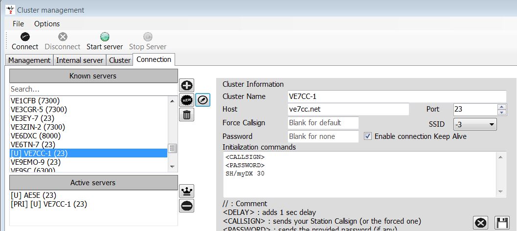

Would you now post your Cluster connection screen, with each cluster's Initialization Commands?
My hunch is that you have an initialization command like Sh/DX 100 or Sh/MyDX 100 for one or more of your clusters. Keep in mind that those commands show PAST spots, and are not affected by the Cluster Maximum Age settings in the Cluster tab of the Configuration settings. They will stay around until they fall off the bottom of the cluster display!
So, to find out, try commenting out any Sh/DX or Sh/Mydx xxx command. I would also connect to only one cluster until we figure this out. See if that helps.

Yes, I have added the "my" into the strings for each server on each computer so my CC Users will function. I will delete the "my" and delete the second "AE5E", and shutdown the extra computer. I have set different SSIDs for all, but maybe something is getting cross-connected. I will be only WB8ASI-1 connected to VE1CC.net to VE1CC-1. No CC User. That should clean things up. BTW, I have scrolled down in the cluster, and have made a few contacts tonight with all working perfectly with JTAlert Beta. Everything logging smoothly. Love the DX Call from JTAlert bringing up to QSO info on the V2 screen. This is fantastic. Good job and thanks to your whole Team. I have left V1 in the dust (well, it's still close by), and moving forward. Just gotta work thru some expected bugs. Here's my setup before my changes....

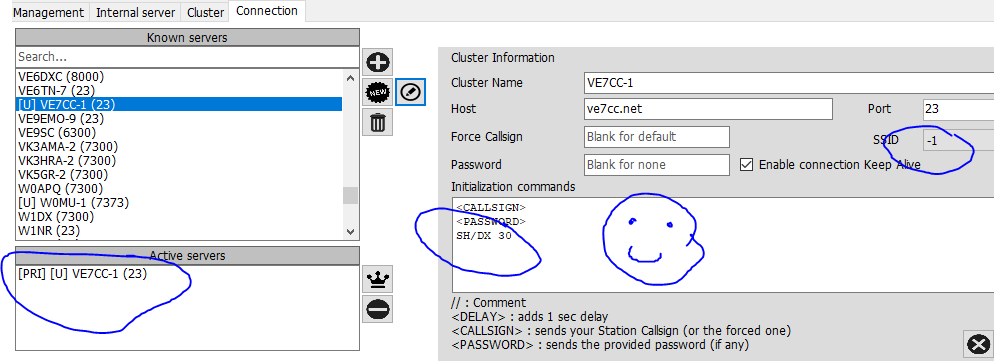

Doug, My easy chair computer Win7 32-bit is OFF. Win10 64-bit is On in the shack. Cluster currently steaming nicely with a few frozen spots rolling down, but mostly good fresh spots coming in. Early in the day, and most of the frozen spots are later, yet they are no longer visible on the screen. Maybe they are gone, or maybe they will reappear when their "time" is due???
I think I'll just let this thing run all night and hope for the best, cuz I'm thinking if I log off and back in, they will all reappear. They are hiding there somewhere LOL. Here's my latest setup. VE7CC.net only. No CC User. No "my". Shack computer only. Only weak spot I see is that this computer (in the shack Win10 64-bit) gives me problems when trying to send you an update over the Log4OM Group. I'll try again, but will copy and send from easy chair laptop if needed. Don't think it's a Red Herring, but wonder what is going on. Both computers have signs of same problem, but a little different. Thanks for hanging in there with me. Daniele might have some kind of award for your customer service. 73, Herb
