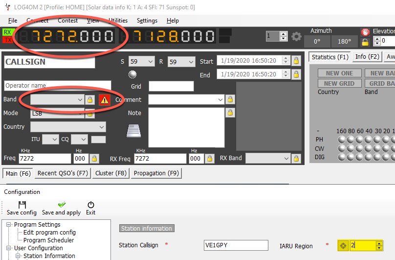

Wrong bandplan
Post by VE1GPY »
When I move my VFO above 7.2Mhz on 40M, the "Band" field is blanked out and a red alert icon appears. This makes it look like it's using a region 1 bandplan even though I have my IARU Region set to 2. I confirmed this by temporarily editing the <user>/AppData/Roaming/Log4OM2/bandpland/bandplan_r1.xml file - which corrected the "Band" field behaviour.
Any idea why it's using a region 1 bandplan and what I might do to change it?
Thanks and 73,
Sheldon VE1GPY

In the <user>/AppData/Roaming/Log4OM2/user/config.json file, I found
Code: Select all
IaruRegion:1
I did a hand-edit to make it 2 and the problem resolved. It looks like the value was not written correctly by the Settings/Program Configuration screen on save and apply.
I confirmed this by using the UI to change the value to 1 and doing a save and apply and a restart of the program. The value in the JSON didn't change. Did it again with a value of 3 with the same result. In both cases, the value in the JSON remained as 2 (from my hand-edit).

Hi Sheldon,
I've replicated this behavior. A fix is forthcoming... thanks for reporting!
