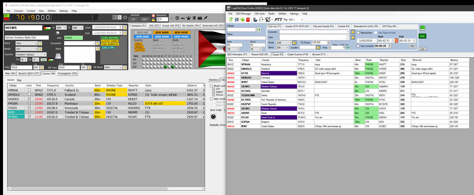

I seem to be missing spots that my local buddies are getting.
I have no filters set.
I pulled up V1 and both are pulling from VE7CC. Both are set to NA spots only.
Cannot figure out why I am missing spots.

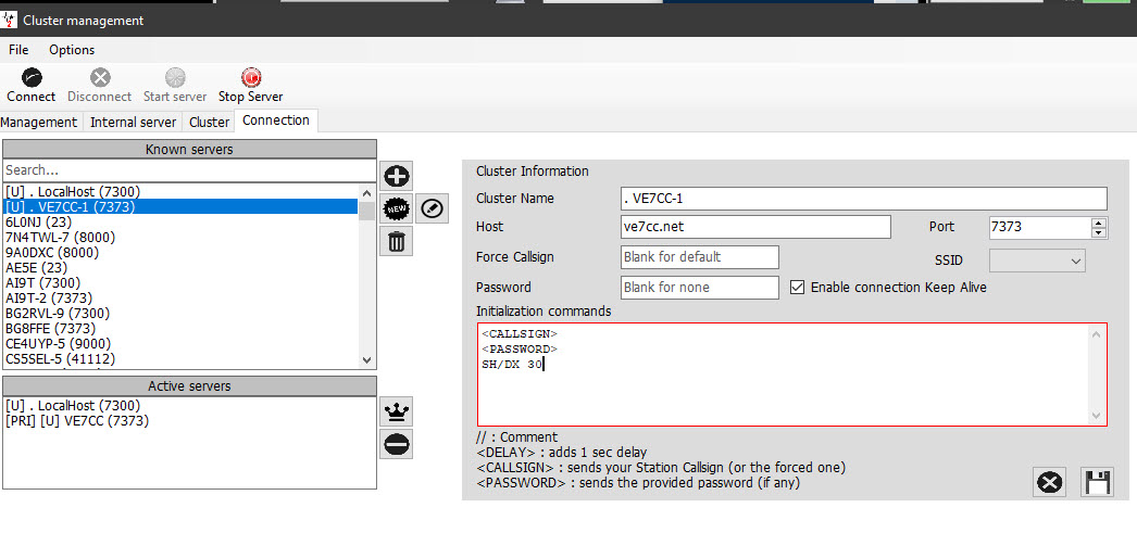

Here is screenshot from V2

Ok, based on that screenshot, you are using the SH/DX initialization command - which is ignore all filters with in the CC Cluster server. But you must have some filters set because the only spots showing are coming from NA spotters. Can I get a full screen shot of your Cluster filters set for V1 and V2.
I would insert an SSID of say 02 for the V2 connection. I am sure VE7CC is going to protest sooner of later by not having distinct SSID's with two connections.
And if you have CC User installed, I would open it, and do a Ask Cluster command for the Country tab (both spotter Cty and Dx Country, the State tab and the Band tab, just to see what filters you may be set within VE7CC server. Once you determine the filters, you can shut down CC User. Btw, there is away to have CC User as your cluster server, with both V1 and V2 connected to it. But that is another adventure. Let me know if you are interested in that. No read advantage, other than maybe a bit more control real time.

I have not paid attention to times and when you start both of them V1 presents you with a decent list right off the back from a few minutes back (or so I think)
V2 seems to show you from that moment forward. Maybe I was just seeing more of the older spots with V1?
But there was more for sure.
