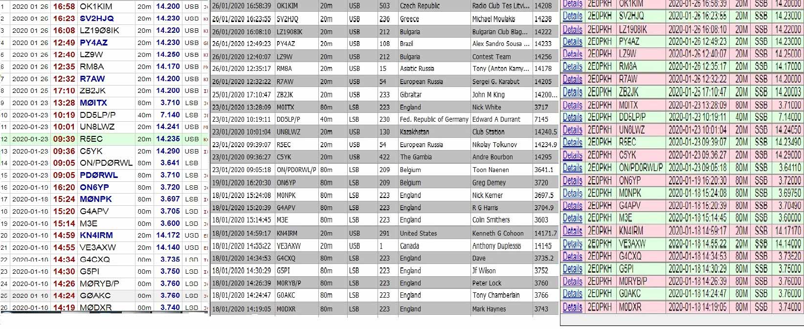

Post by 2e0pkh »
Hi, just seen this in my logs, the frequency is different than what it is in QRZ & LOTW. I'm using cat control to my Yaesu FT 450D & what frequency shows on the radio is the same as what is shown in Log4OM window. This started since I installed version 2, now using version 2.2 & Windows 7.

Can you share some screenshots of the same QSO in Log4OM, QRZ and LotW ?

He did with his first post

I take the QSO with G3RWF as an example
1.) QRZ.com displays 3.737 (1st screen from the top left)
2.) Log4OM displays 3737.5 (middle screenshot)
3.) LoTW displays 3.73750
looks good to me. Can you share an example where it is off by several kHz ? Too painful to go through all of your QSO in your initial screenshots.

Check out QSO with GM3POI 18/01/20 its 6kcs out
