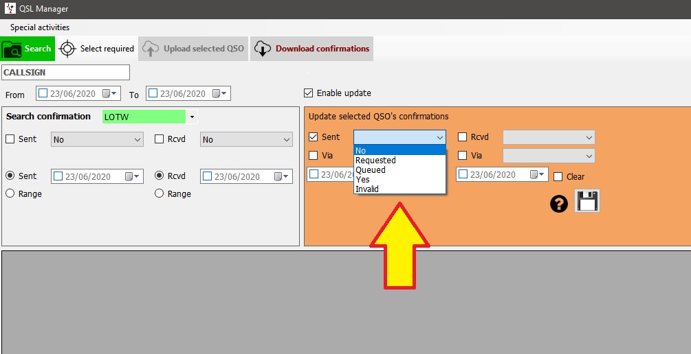

Incorrectw9mdb wrote: 23 Jun 2020, 16:53
#2 Then I thought I'd do a batch update...can't do that either because the LOTW QSL info is not exposed in the current database structure for doing sql updates either singled field or batch.
Using an SQL query is unnecessary and beyond the ability of normal users and is not required.
You should use enable update in the QSL manager, watch our video tutorial for fuller instructions but meanwhile perhaps this screen shot will help.

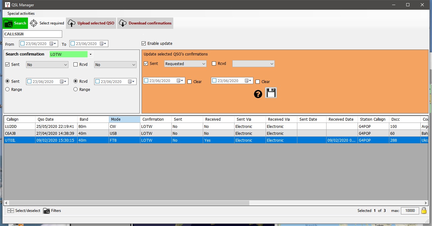

- Posts: 11601
Re: QSL sent = No from JTAlert
w9mdb wrote: 23 Jun 2020, 16:53 #1 If you try to change Sent Status to No, then click the Sent Required the program changes the Sent box back to Requested and nothing gets selected (even though there are lots of QSOs with No status).
Dont fully comprehend what steps your taking there but it sounds like you missed clicking the floppy disk save icon before save and apply, see below

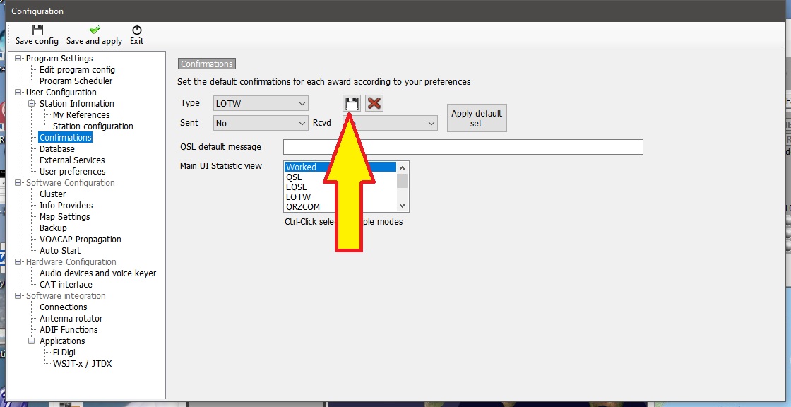

And is the text in that box wrong or rather unclear?
"Consider QSO to be uploaded when SENT status is"
Should it be
"Consider QSO ready to be uploaded when SENT status is"
The first one sounds like it's already uploaded.
Mike
Both of your suggestions for workarounds work...but that's not desirable behavior when the fix is to make the Snet pulldown work correctly for choosing LOTW sent status.
Should it be
Mike
- Posts: 11601
Had you changed that the incorrectly marked Qso's would have uploaded, see our user guide and YouTube tutorials
