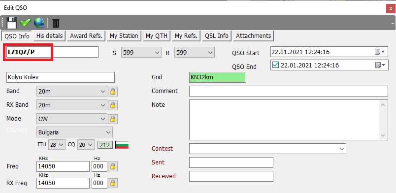

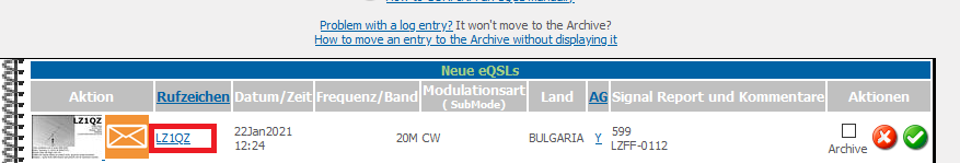

As an expample my contact with a /P station which operates with /P but confirms without:
if you see messages like this you must open the contact in the QSO manager and check
on eQSL and/or LotW site where are differences. I got things like this if time or date
are wrong, if the upoloader has a wrong mode used or if you logged him with an extension
like /P, /M or /MM but he confirms without this.
To check this out it´s handmade work, HI.

thank you much for this lead. for this QSO the other operator put the mode as Olivia and I put it as Olivia 8/250. i will review the others and see what I find. I will post more info if I run into trouble.DF5WW wrote: ↑26 Jan 2021, 06:52 Hi Dave,
