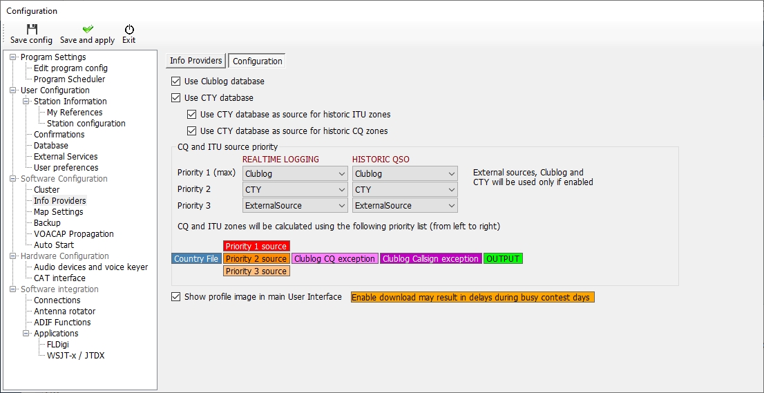

Dick,
Go to Settings/Program Configuration/Software Configuration/Info providers. Click on the Configuration Tab. Do you have "Use Clublog database" checked? That might be why we are getting different results. As I said, in your examples, including PJ2MAN, I get zone 9. The attached picture shows what I have set. It shows I have "ExternalSource" set as my third priority, but I don't usually use them.
Jim N6VH

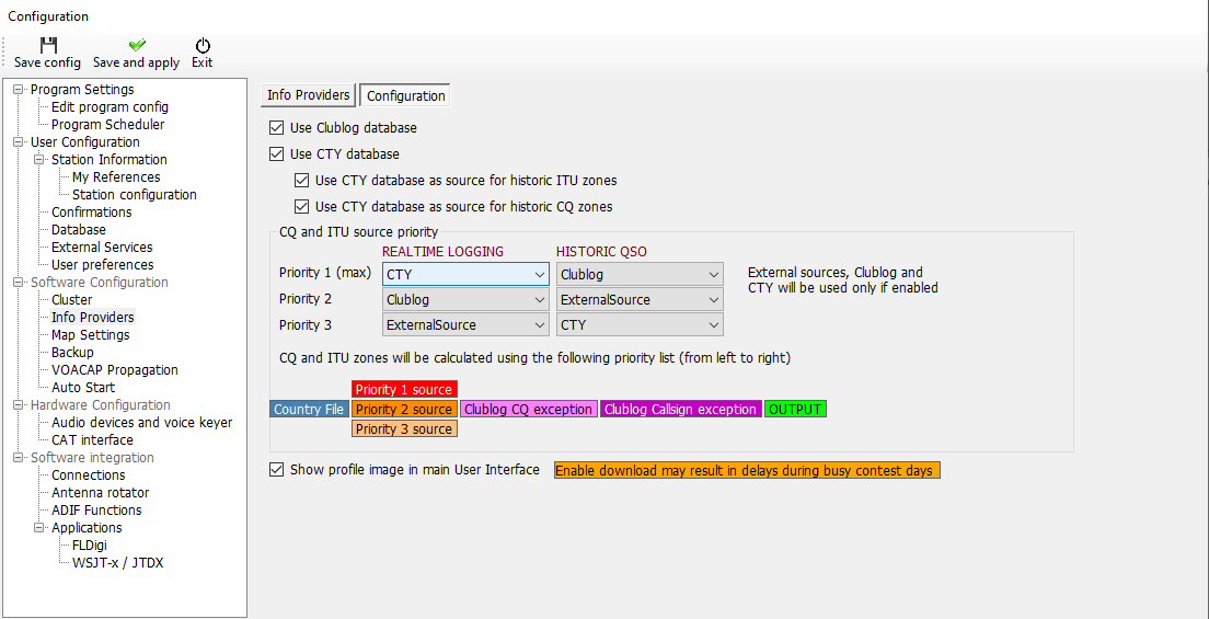

Jim,
My settings were indeed different.
I then adjusted the settings as you described it. Saved settings and then restarted Log4OM.
However, the result is still the same see here:
73 Dick
73 Dick
