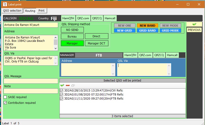

I am making great strides in the printing of the QSls
I have a problem in the management (Routing)
example : with 3D2AG in my QSL Via field in my Log I have "OQRS Clublog"
but in the "routing" tab it always puts "Manager: FT8"
I therefore suppose that Log4OM does not take into account the value of the "QSL Via" field entered in the log but take this value automatically I do not know where (QRZ.com?)
is it possible to modify this in this "Routing" tab before print ?
I haven't seen anything in the documentation on the subject and I tried to modify it manually but whatever I do it always prints " FT8"

Hello Terry
YES I Think
I modified FT8 to "F6FLU" for example, I validate by clicking on the green tick at the top right
but it still prints FT8 ...

OK now I understand what your issue is and having checked this out I find we have a bug because even having edited the QSO QSL sent via information it is not reflected in the label print routine because it is being overwritten by on line look up information.
I will move this thread to error reports and add it to our Mantis list
Thank you for finding this bug

That's not possible due to the application design.
QSO with the same callsign are grouped in a single "object" that contains multiple QSO potentially printable into a single QSL.
Those QSO *may* have different QSL SENT VIA status so the application is unable to identify the right one if the status is not aligned.
The "online" way is a way to find the most current address and qsl routing path also for old QSL never sent before, with the mostly accurate information
